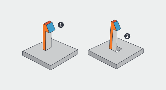

Undercuts can make it difficult to impossible to remove parts from molds without damaging the finished part. Good design can work around them.
Undercuts on injection-molded parts are features that prevent those parts from being ejected from the mold they were made in without damage. With straight-pull molds, undercuts include any protrusions, holes, cavities, or recessed areas in the part where alignment is not perpendicular to the mold’s parting line. If possible, the best way to deal with undercuts is to eliminate them in the design.
Some examples include the threads on an injection-molded fastener, a hole running the length of a plastic hose barb, a slot for a power switch in the side of a smartphone case, an angled boss on the exterior of a hydraulic manifold, and the locking tabs on the base of a taillight lens.
There are many more such parts, all of which require a little molding magic—or at least some minor design modifications.

The plastic case mentioned above brings up another common molding technique. Telescoping shutoffs (aka sliding shutoffs) are often used to create clip-and-hook-mechanisms. These are commonly used for locking together two halves of a molded product. In many cases, they eliminate the need for side-actions, inserts, and bumpoffs that add complexity to a mold. The “telescope” is machined into one half of the mold and extends into the opposite side during molding, “shutting off” certain part features.
Shutoffs offer an elegant way to simplify mold design and reduce product costs. Just be sure the part and mold have enough draft—add a minimum of 3 deg. from vertical, if possible—or else there might be metal-on-metal rubbing, creating flash or prematurely damaging the tool.
