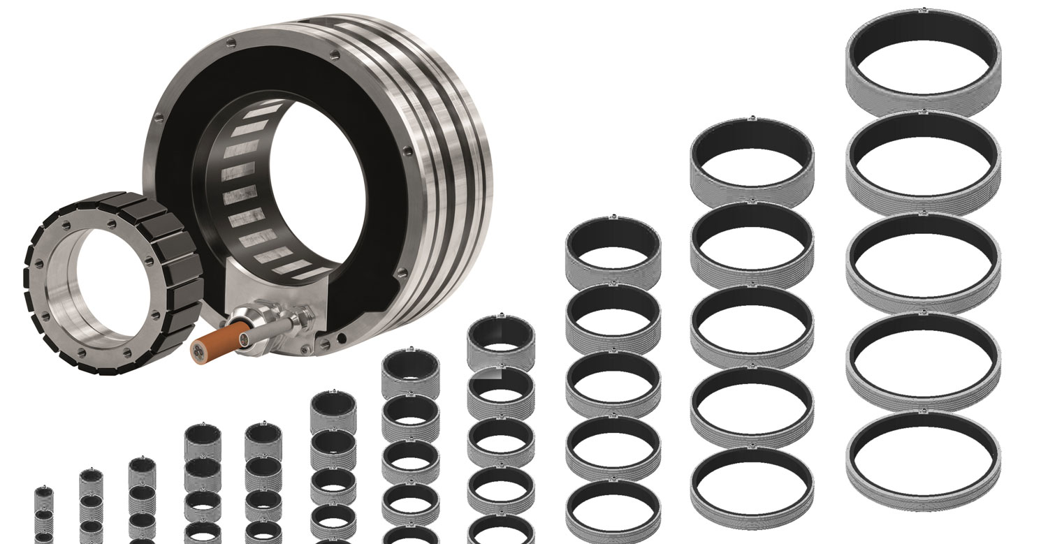

TMB+ direct drive motors

When ETEL released the TMB+ a few years ago, increasing the torque density of the previous models was one of the design priorities when it came to advancing direct drive motor design.
2. More size options. Direct drive motors are key components in machine tools from a performance and product quality point of view because they must provide the tool-turning power profile within a certain volume. Increasing geometrical variation in motor design gives machine builders more flexibility in fitting in the best motor for particular applications in the space available.
Torque motors have the variables of diameter, length, and power. But it’s not as challenging as it once was to find the ideal mix. For example, if the outer diameter of a motor is limited then there are often many height options available  to still maximize torque.
The variety of sizes available also offers cost flexibility. For example, the ability to increase the length of a linear motor can reduce width and, in turn, the amount of costly magnet material along the length of travel. Having a large variety of sizes lets machine makers more easily maximize the space and efficiency of the machine, so much so that it may start to feel like the motors were made just for the machine and not the other way around.
ETEL’s line of TMB+ direct drive motors range from 160 mm (6.3 in) to 1288 mm (4.2 ft).
