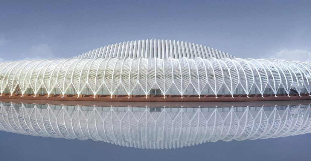

Engineers and architects in Florida were challenged to complete the Innovation, Science, and Technology (IST) Building at Florida Polytechnic University in Lakeland, Fla. It was designed by  Spanish architect Santiago Calatrava Vall and will be the centerpiece for Florida’s newest state institution. It will house classrooms and auditoriums for teaching science, engineering, and math, as well as administrative offices, common areas, and a number of cutting-edge laboratories. The latter include a Supercomputer and Student Data Center, a Visualization and Technology Collaboration Lab, and a Rapid Application Development Makerspace Lab with 3D printing capabilities. The $60 million, two-story building also includes 94 louvered arms that raise and lower to track the sun above a glass roof.

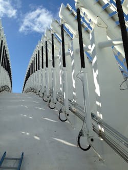

An array of rod cylinders in five different sizes keep the louvres at the right angle to either provide shade or artistic motion.

For the building, each cylinder was assembled with cartridge valves on a manifold, which was bolted to the cap and plumbed to the head end of the cylinder. Further, a spherical rod eye was installed at the rod end and the entire cylinder was painted to match the remainder of the structure.
The cylinders act independently from one another and can manipulate the louvers to provide shade and artistic motion. The louvers are designed to eventually carry photovoltaic tape to generate power for the campus. Each louver arm can move from 65 deg. above the horizontal plane to 48 deg. below that plane. Travelling the full 113 deg. takes about 10 min.
