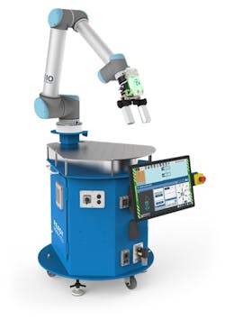

During the tour, Gibbs didn’t disappoint. He might be from business, but the company was developing technology for people with minimal to no experience. To prove this, Gibbs took about five minutes to show me how to setup a robotic cell. Making some connection of pneumatics and power to the base a collaborative robot was sitting, Gibbs set up the cell to grab a part, load it into a lathe, start the lathe operation, and unload the part.
Ready Robotics created a cell that can be easily integrated with almost any robotic arm, end-effector, and other systems to create a plug-and-play robotic work cell that anyone can program.
This might seem basic, but applications like this can free workers from being interrupted from more important or complex tasks. Also, a cell like this could do many things, so as the factory floor changes the cell can change. With the easy-to-program pick-and-place programming on many collaborative robots, and the block programming anyone should be able to change or add tasks to the cell.
Not associated with Ready Robotics, MIT released Scratch. It is block programming to teach kids how to code. However, it was so popular it wasn’t long until I ran into an ABB engineer that had used it to program an industrial robotic arm. This is the same concept used by Ready Robotics. You can create blocks to perform an action, such as open/close gripper. Then, like building blocks, you select and drag the block you’ve created into a visual stack of blocks. The lathe demonstration took less than a dozen blocks, all of which were selected from a premade library of blocks.
With flowchart logic, block programming, and a collaborative robot’s ability to simplify the robotics’ arm programming, the robotic cell seems only limited by what end-effector you select and the reach of the arm. While impressive, one of the simplest smallest things was almost passed over. While Gibbs was setting up the demo, he casually connects a pneumatic device to operate the HMI.
The Forge Station R10 has a reach of 51.2 in., a payload of 22 lb, and a speed of 39.4 in. per second.
It was simple and brilliant. Often when people are programming robots a human will still interact with the HMI. For example, the robotic cell could load and unload the lathe, but a human might still be pushing the buttons on the HMI to open and close the lathe’s chuck. This could leave a machine waiting on a human to push a button before continuing to the next step.
Some solutions will have the robot start the machine but, in the case of operating a chuck, the robot can’t hold a part and push buttons on the HMI. Additionally, pushing buttons might not be easy depending on the geometry or the end-effector and the button size and configuration on the HMI. Finally, collaborative robots are regulated to how fast they can move. Using the robot to operate the HMI will increase cycle times.
Ready Robotics’ solution was to make a small pneumatic button pusher that can plug into the robotic cell and be clamped mechanically or magnetically to an HMI. Since this tour I’ve seen other button pushers but, like most of the convenience of a robotic cell, this puts everything on one platform for faster integration and easier operation.
