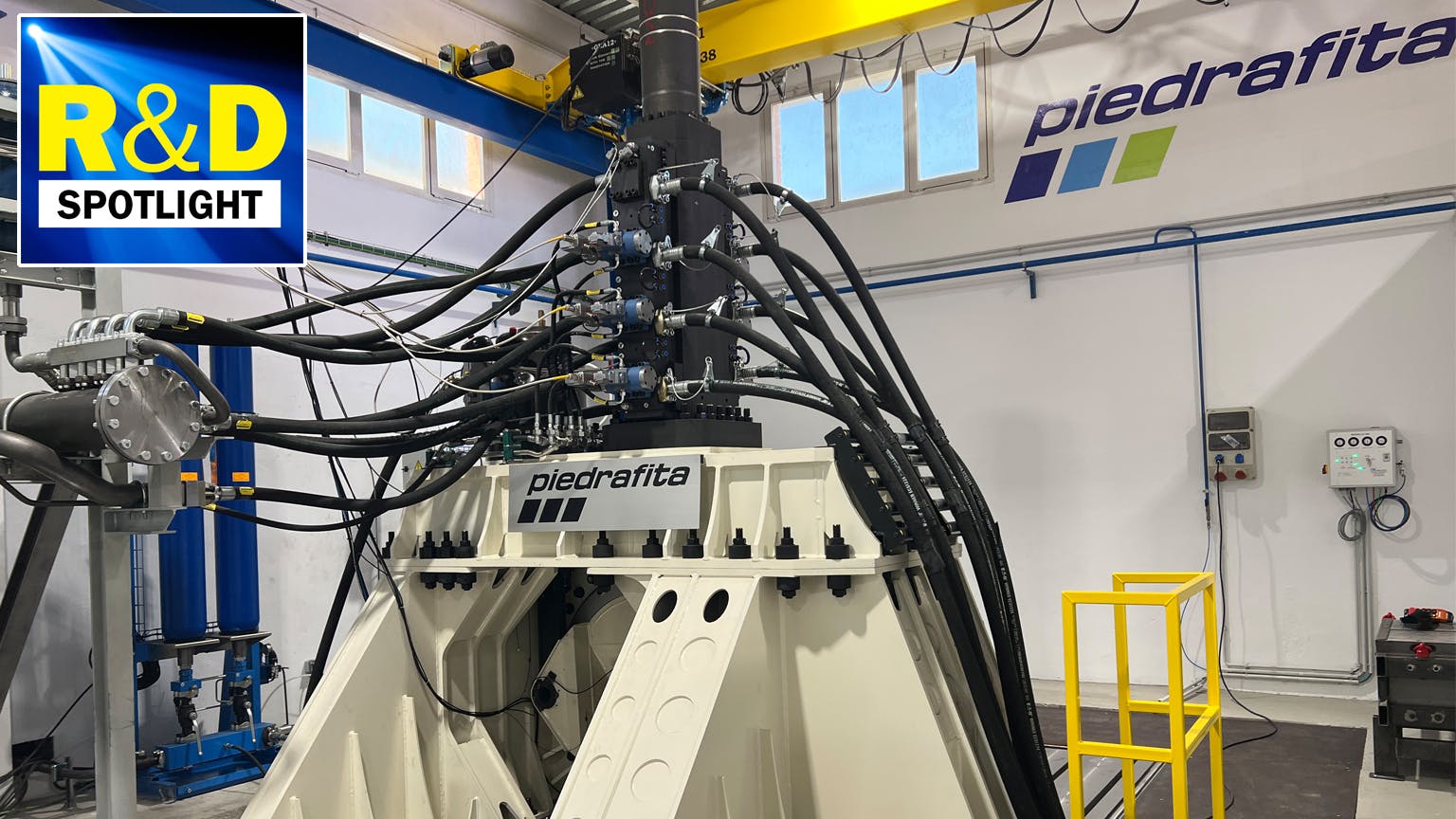

Spain-based Piedrafita Systems, which develops rotary suspension solutions for military land platforms, worked closely with Moog engineers to design the Merlin test bench, a high-performance test rig that would be used in designing heavy-duty vehicle suspensions. Piedrafita Systems specified the need for a fatigue test system capable of delivering forces up to 500 kN (80,000 joules per meter) at a speed of 8m/s and up to 200 Hz.

This time, however, Piedrafita and Moog’s design and test engineers went above and beyond to deliver a test bench system that not only simulates the movement of an armored vehicle’s tracks over uneven terrain but can reach five times higher forces at twice the velocity and double the frequency range. This level of vibration is crucial for evaluating the resistance and performance of shock absorbers as well as suspension systems in combat scenarios.
The system combines the heavy-duty loading typically found in a high-capacity hydraulic press with the speed and fidelity of a motorsport 4/8-poster rig.
According to the engineers, the test rig is designed to replicate the movement of an armored vehicle over an APG track, as the vibrations experienced during the run are critical in assessing the resistance and related capabilities of the shock absorbers and suspension during combat. The test bench includes a high-performance controller and customized actuators that can reproduce vibration up to 100 G, according to Moog’s chief engineer, Ian Whiting. Nonstandard turbocharged valves were used to achieve the 500kN, 8m/s, 200Hz and 100 G corners of the operating envelope.

Essential components making up the test system include: a Moog test controller, two hydraulic actuators with Moog digital servo valves, an HPU with Moog digital pumps and a power cabinet, and an accumulator bench with the required piping.
Moog’s Analysis and Simulation Toolbox was also used to demonstrate the likely performance of the proposed twin-actuator servo system. Typical functions of the software include processing customer data, building Simulink models (a MATLAB-based graphical programming environment) and running model cases studies. The simulation software was used to relay the required motions and forces to the test article, according to Moog’s engineers.
