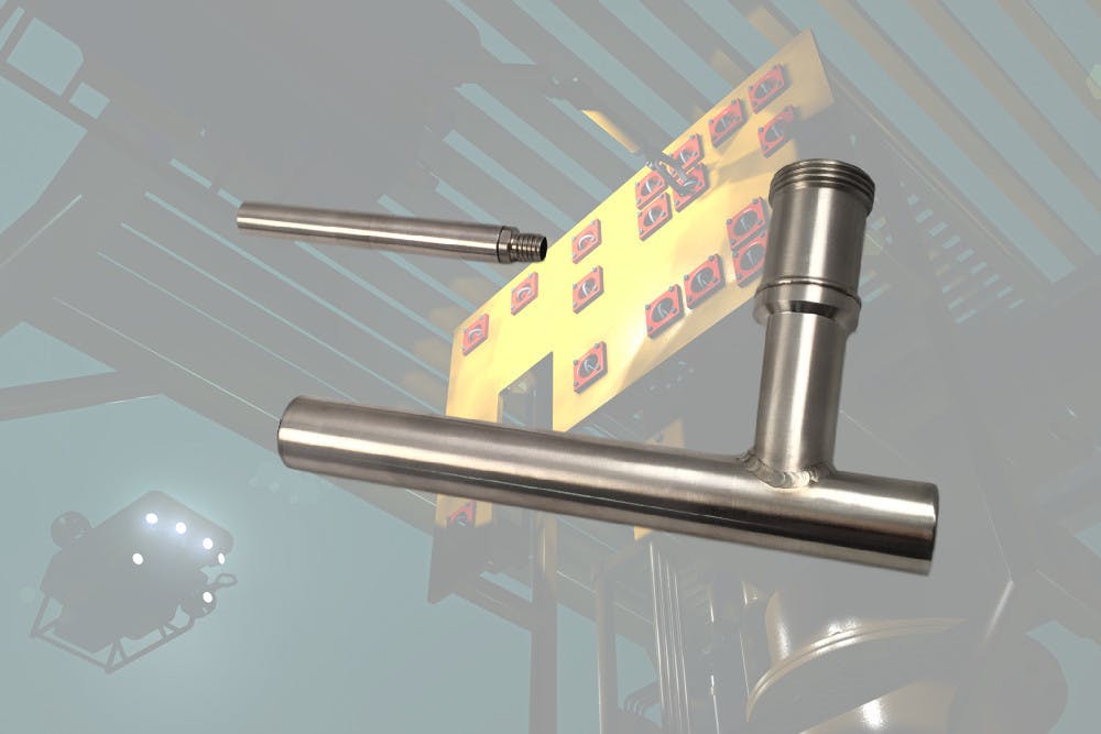

Figure 2: The higher content of nickel, chromium and molybdenum in the alloys used by NewTek to encase the LVDT assembly extends the corrosion resistance of its Submersible Position Sensors.

Higher pressures. The use of high-strength alloys now allows LVDTs to be hermetically sealed to pressures of 20,000 psi, making them suitable deep subsea environments, downhole use near cutting tools for oil exploration and other extreme high-pressure applications such as pressure test vessels and hydraulic actuators. They serve as ideal replacements for load cells, pots and magnetostrictive sensors in underwater use. (See Figure 2)

Greater reliability. LVDTs can be constructed with special alloys such as Monel, Inconel, Hastelloy and Titanium to extend their reliability when operating in challenging environments like seawater, corrosive acids as well as high/low temperatures and pressures.
Exotic alloys such as those that contain cobalt, nickel and chromium can deliver even higher performance from LVDTs where comparable technologies will not survive. For instance, a higher content of nickel, chromium and molybdenum extends chemical resistance to seawater in depths to 10,000 ft and external pressures of ~5000 psi.
LVDT construction materials are chosen based on parameters such as corrosion, pressure, and magnetic properties across the operating temperature range.
