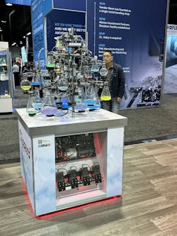

Passersby couldn’t help but be mesmerized by a curious contraption on display at Clippard’s booth at MD&M West 2025.
The pneumatic music machine was intended to showcase the specialty valve company’s different pressure and flow control capabilities. It featured different types of valves, as well as pressure controllers that rapidly changed the pressure and flow of air across beakers filled with brightly colored liquid. The resulting sound created music. “Flight of the Bumblebee” was the orchestral interlude playing as I stepped up to inspect the display.
The Trappings Behind the Music
Housed at the bottom of the display were four Cordis CHV high-volume boosters. These high-flow pressure controllers produce a high flow of air and enable accurate pressure control. In addition, it housed the electronics, including a music interface (MIDI) for converting the air flow (pitch) to a signal that the pressure controllers and valves can understand.
