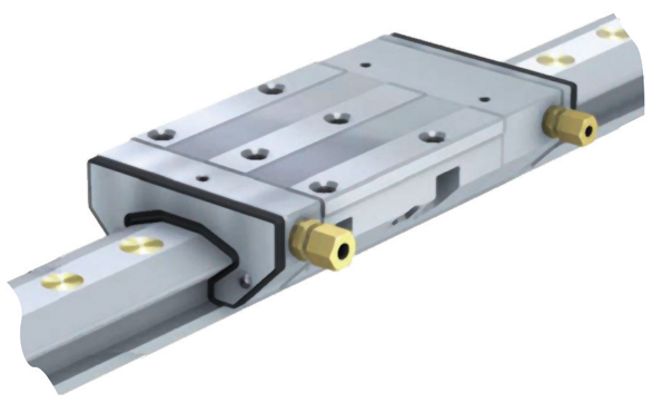

New compact hydrostatic guides operate as complete closed-loop units. Carriages ride on precision-honed guideways energized by a layer of pressurized oil.

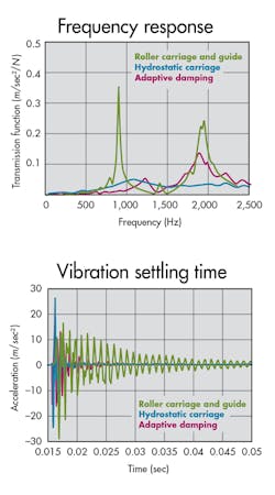

To prove the effectiveness of hydrostatic guides, three different slide assemblies were tested on a motion table.
These compact hydrostatic guides operate as a closed-loop unit. Carriages with pressure pockets ride on precisely honed guideways energized by a steady layer of pressurized oil. The hydrostatic guide carries loads on these oil-filled pressure pockets.
The carriage consists of a steel saddle plate and two end pieces. One end piece has an integrated pressure regulator that supplies oil to the carriage’s pressure pockets. The other, a suction-side end piece, extracts depressurized oil and sends it back through the oil circuit.
Impact tests on the motion table measured modal response and settling times. Results show that damping carriages significantly reduce dynamic response. Hydrostatic systems perform even better, as they almost completely eliminate such effects.
To prove the effectiveness of this type of hydrostatic guide, we tested three different slide assemblies, one at a time, installed in a motion table. The first configuration used standard Size 45 roller carriages and guides; the second slide included damping carriages between the roller guides; and the third used hydrostatic carriages and guides.
For each setup, we applied a controlled impact force at the center of the table and measured the vibration response using an accelerometer. Results show modal response and settling times from this impact. With the standard roller system serving as the baseline, the additional damping carriage significantly reduced dynamic response. But the hydrostatic system achieved the best result, virtually eliminating the dynamic response.
The advantage of the hydrostatic carriage and rail is that it fits into the same design space, with the same mounting-hole locations, as standard linear guides. Thus, engineers can spec them into machines with minimal design effort. An OEM can now offer machines using standard linear guides, with adaptive damping carriages, or with upgrades to complete hydrostatics on the same machine platform, depending on customer requirements. New designs can focus on reducing structural mass for higher accelerations and traverse speeds.
