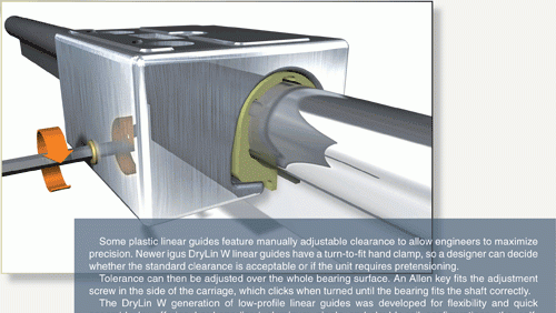

Some plastic linear guides feature manually adjustable clearance to allow engineers to maximize precision. Newer igus DryLin W linear guides have a turn-to-fit hand clamp, so a designer can decide whether the standard clearance is acceptable or if the unit requires pretensioning.
Tolerance can then be adjusted over the whole bearing surface. An Allen key fits the adjustment screw in the side of the carriage, which clicks when turned until the bearing fits the shaft correctly.
The DryLin W generation of low-profile linear guides was developed for flexibility and quick assembly by offering hard-anodized aluminum single and double-rail configurations; the self-lubricating triboplastic helps carriages glide smoothly over the rails.
igus DryLin W carriages also form the basis for some ready-to-install linear slide tables, to which the new clearance adjustment can also be added.
