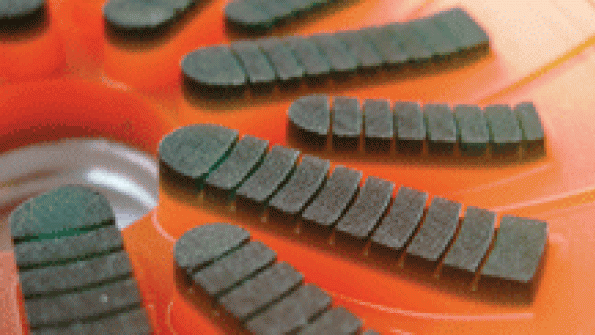

One way to cope with higher speeds and quicker stops is to switch from suction cups to friction cups. They have high coefficients of friction and can exert more force. Most friction cups have their internal surface covered with patterns of knobs and oil channels. Many such cups have a good friction grip initially. However, wear on the cups from normal usage soon degrades the pattern and the cups have more or less the same performance as conventional cups. Users must frequently change cups to maintain performance.
Some friction cups, such as Duraflex cups from Piab, Hingham, Mass., carry a friction pattern that resembles those on winter tires. The cups and patterns are polyurethane, but the polyurethane used for the patterns has a harder durometer. They work best with vacuums from –40 kPa (–12-in. Hg) to –95 kPa (–28-in. Hg). And the friction performance will last the entire life of the cup. In fact, the initial wear slightly improves the friction grip.
