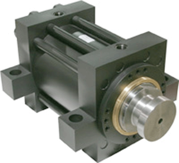

Some hydraulic cylinders are specifically designed for heavy-duty industrial operations.
