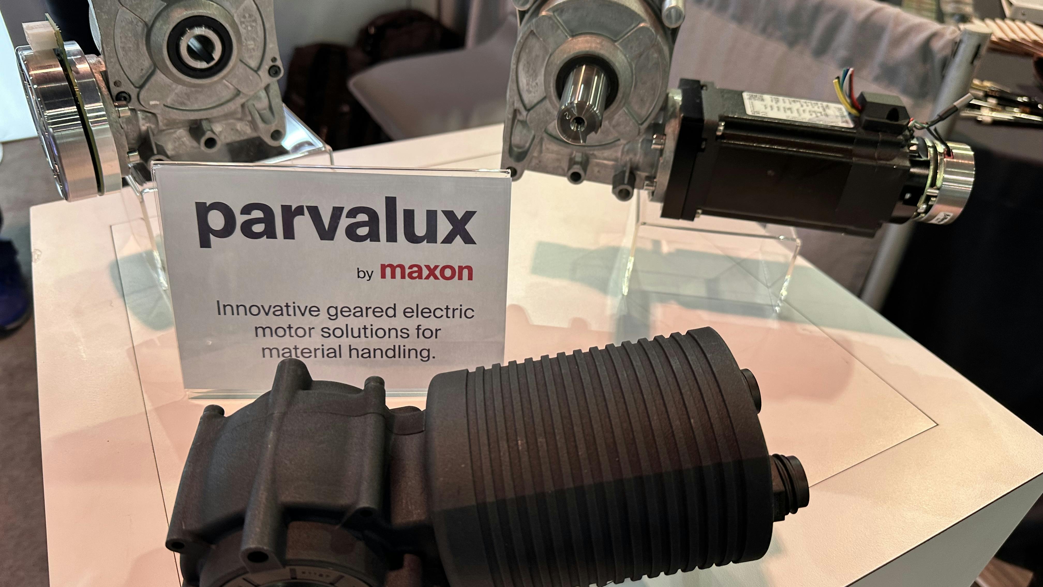

A new compact drive unit incorporates both Maxon and Parvalux technology. “It features an ECI 76 frameless Maxon motor with a Parvalux right-angel gearbox,” said Jacob Gelinas, sales engineer, Maxon. “The gear set was developed on a separate gearbox but has been made much more compact for this particular solution as everything is housed in one unit.”
The drive unit is available with the motor and gearbox combination but is now available with the addition of a controller or brake, Gelinas said. The complete system is housed inside an IP67-rated enclosure.
The system is IP67 rated and maxon has the capacity to make it available with a connector that goes up IP68 for tough environments, said Alex Valentino, head of sales, Parvalux USA. He added that the system is ideal for customers looking for a “torque-dense package.”
The motor comes in three different sizes (60mm, 76 mm and 90 mm); the largest one delivers up to 400 mNm of torque, according to Valentino.
Gelinas noted that each motor can be paired with Maxon’s modular gearboxes and offer multiple ratios to fine-tune speed and torque output for any application. In addition, the company has installed standard IP-rated connectors, making the system ideal for plug-and-play installation.
