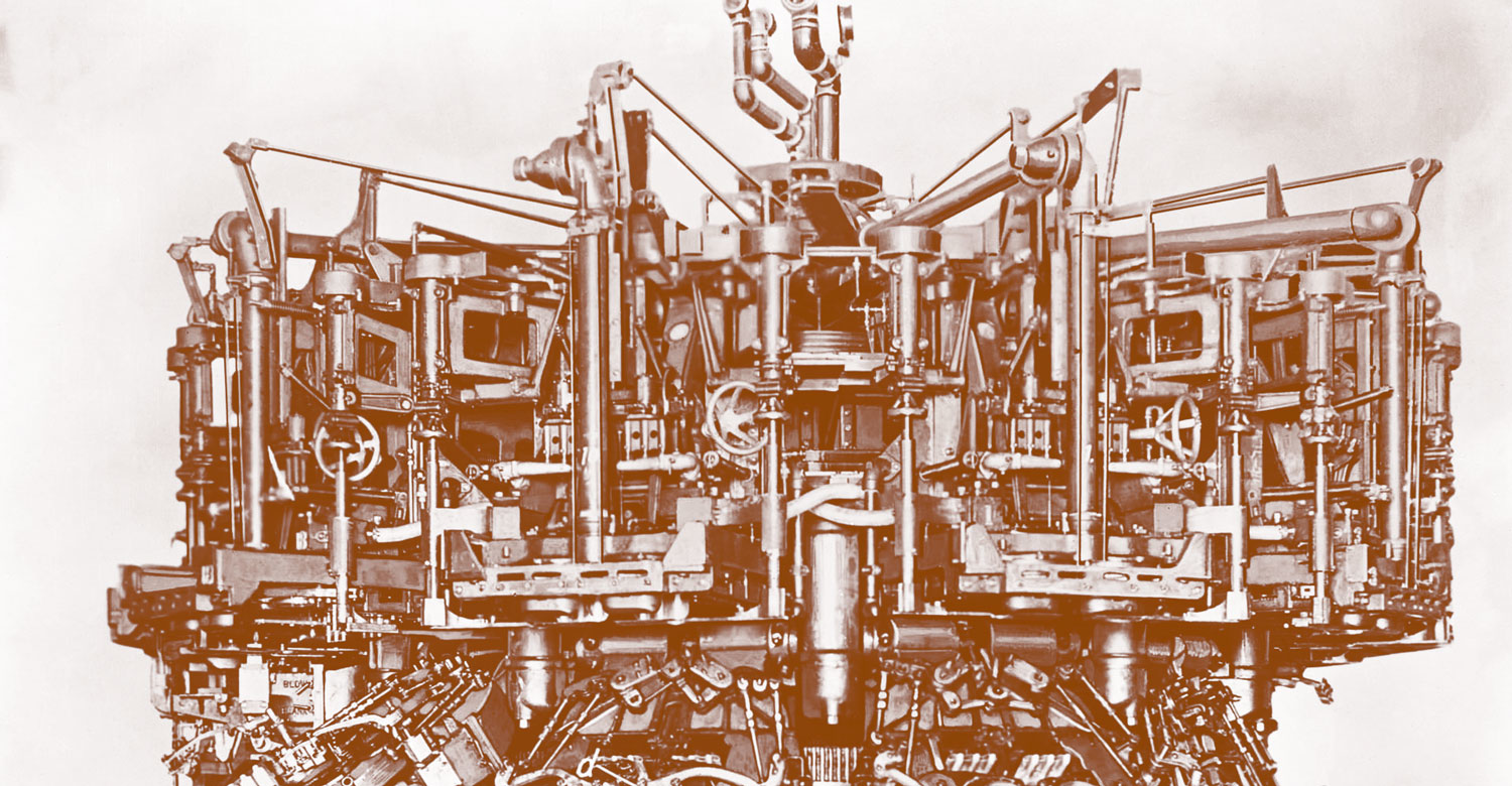

Owens AR Bottle Machine (1903)
Up until 1903, all bottles and gas jars were blown into molds by skilled operators assisted by a horde of young boys. It took six men plus those boys 12 hours to make 2,880 bottles at $1.80 a gross. That’s because glass was difficult to work with. It also contributed to the child labor problem. Then Michael Owns, financed by Edward Libbey, automated the process in 1903 with his “A” machine. It turned out 17,280 bottles in 24 hours and only needed two operators. Costs dropped to 12 cents per gross. The key was using a pump. It would suck a gob of molten glass into a mold which formed the neck of the bottle. Then that mold went onto the large mold for the body of the bottle. The pump’s return stroke blew air into mold, inflating the still-molten glass into the shape of a bottle. Further refinements over the years led to the “AR” machine. It could crank out 50,400 bottles per day and could make bottles and jars of various shapes, volumes, and weights. One version of the AR machine contained 10,000 parts, weighed 50 tons, and had up to 15 arms, each with air blowing through it to expand glass. In 1913, the NYC National Child Labor Committee said the rapid introduction of bottle-making machines did more to eliminate child labor than any of their legislative efforts. By 1923, 94% of all bottles in the U.S. were made by machine. The last two Owens machines, “AQ” models, were used until 1983.

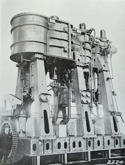

Joshua Hendy Iron Works (1906)
Joshua Hendy supplied Gold Rush miners with hardware from 1856 until 1906. That’s when an earthquake destroyed his San Francisco plant, as well as much of the city. He rebuilt in Sunnyvale and continued to turn out equipment for miners, including mine cars, buckets, stamp mills, and ore crushers, as well as the hydraulic “giants” used to dig the Panama Canal. Hendy pioneered the making of large machines in the West. His foundry also turned out most of the fire hydrants and street lamps, along with Chinatown’s oriental lamp posts, for the rebuilt San Francisco. During the Depression, the factory stayed open making gates and valves for the Boulder, Hoover, and Grand Coulee dams. His factory was crucial in both World Wars for making marine engines. During WWII, for example, his factory made about one-third of the engines for U.S.-built Liberty Ships—about 754 of them. Within a year of first making the engines, his workers could turn one out in 1,800 hours; a year before, that task had taken 4,500 hours. He slashed the time needed by introducing advanced assembly line techniques, standardizing production parts, and enabling less-skilled workers to accomplish tasks that once required skilled machinists. The plant was sold to Westinghouse in 1947; it went on to make steam turbines, switchgear and motors, and 216,000 hp wind tunnel compressors.

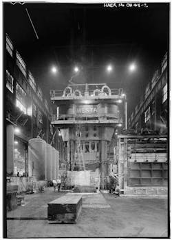

ALCOA 50,000-ton Hydraulic Forging Press (1953)
During WWII, examinations of downed German aircraft revealed forgings that were beyond the capability of any Allied country to produce. Although the U.S. tried to scale up its forging capabilities, it was only after the war, when the U.S. seized some of the larger German forges, that U.S. efforts shifted to high gear. (The Soviets grabbed the largest, a 30,000-ton press, while the U.S. made do with a few 15,000 German presses.) One of the first presses to come out of this effort was one built by Mesta, which has been operated by ALCOA since 1955. The eight-story machine has been critical to U.S. defense and aerospace programs. The press weighs 8,000 tons and there are 2,100 tons of moving weight. Hydraulics controlled by a 30-foot camshaft provide the pressure to boost the forging force to 50,000 tons.
