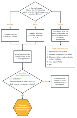

The first step in calculating a preliminary T-code is determining the maximum surface temperature and internal enclosure air temperature based on the heater design operating in the most demanding conditions while remaining within design specifications. These conditions include maximum process temperature influence, full power/amperage operation, maximum ambient temperature for installation location, and solar load if applicable.
As Watlow engineers have proven, an enclosure’s internal air temperature is affected by the pins that attach heating elements to the electrical termination. With enough amperage flowing through them, the pins and other electrical supply connections can become “small” heaters and could dramatically increase temperatures inside the enclosure.
Once the preliminary T-code is determined, those who design electric process heaters must reveal whether the preliminary T-code is cooler, the same, or hotter than the customer-specified T-code. The answer to that question is an important guide in developing the heater.
If it is cooler than specifications, the design team should proceed with the cooler T-code. If it is the same, they should use the customer specified T-code. If the preliminary T-code is hotter, then the proposed design does not meet customer requirements and the design must be changed to meet the customer specified T-code.
The last step is to verify the enclosure service temperature rating will not be exceeded. The maximum surface temperature is evaluated such that even if it were to reach the assigned T-code temperature limit, the enclosure service temperature rating will not be exceeded. This ensures all internal enclosure components are suitable for the expected worst-case temperatures.
An enclosure operating with a service temperature higher than the maximum can cause two problems. First, there is a potential safety risk as the heater will be operating at service temperatures beyond its rated temperature. If ignition happens at that elevated temperature, the integrity of the enclosure may fail and not contain an explosive event. Additionally, if the temperature exceeds internal component ratings, there is a higher chance of component degradation and an increased chance of early equipment failure.
It is very important to comply with the current standards that define the evaluation scope to be from the flange (heat source) to the electrical enclosure, as well as fully accounting for all the heat generated inside and outside the enclosure. Failing to do so could mean an unsafe situation or could result in the authority having jurisdiction (AHJ) not approving the equipment installation, causing potential schedule delays and/or cost overruns.
