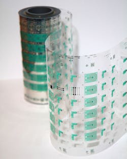

Javey and his team worked with researchers at the VTT Technical Research Center of Finland to develop a way to quickly manufacture the sensor patches in a “roll-to-roll” processing technique similar to screen printing. Roll-to-roll manufacturing essentially prints the sensors onto a sheet of plastic
“Roll-to-roll processing enables high-volume production of disposable patches at low cost,” says VTT’s Jussi Hiltunen. “Academic groups gain significant benefit from roll-to-roll technology when the number of test devices is not limiting the research.”

The sensors can be rapidly manufactured using roll-to-roll manufacturing prints the sensors onto a sheet of plastic. (Courtesy: Antti Veijola, VTT)
