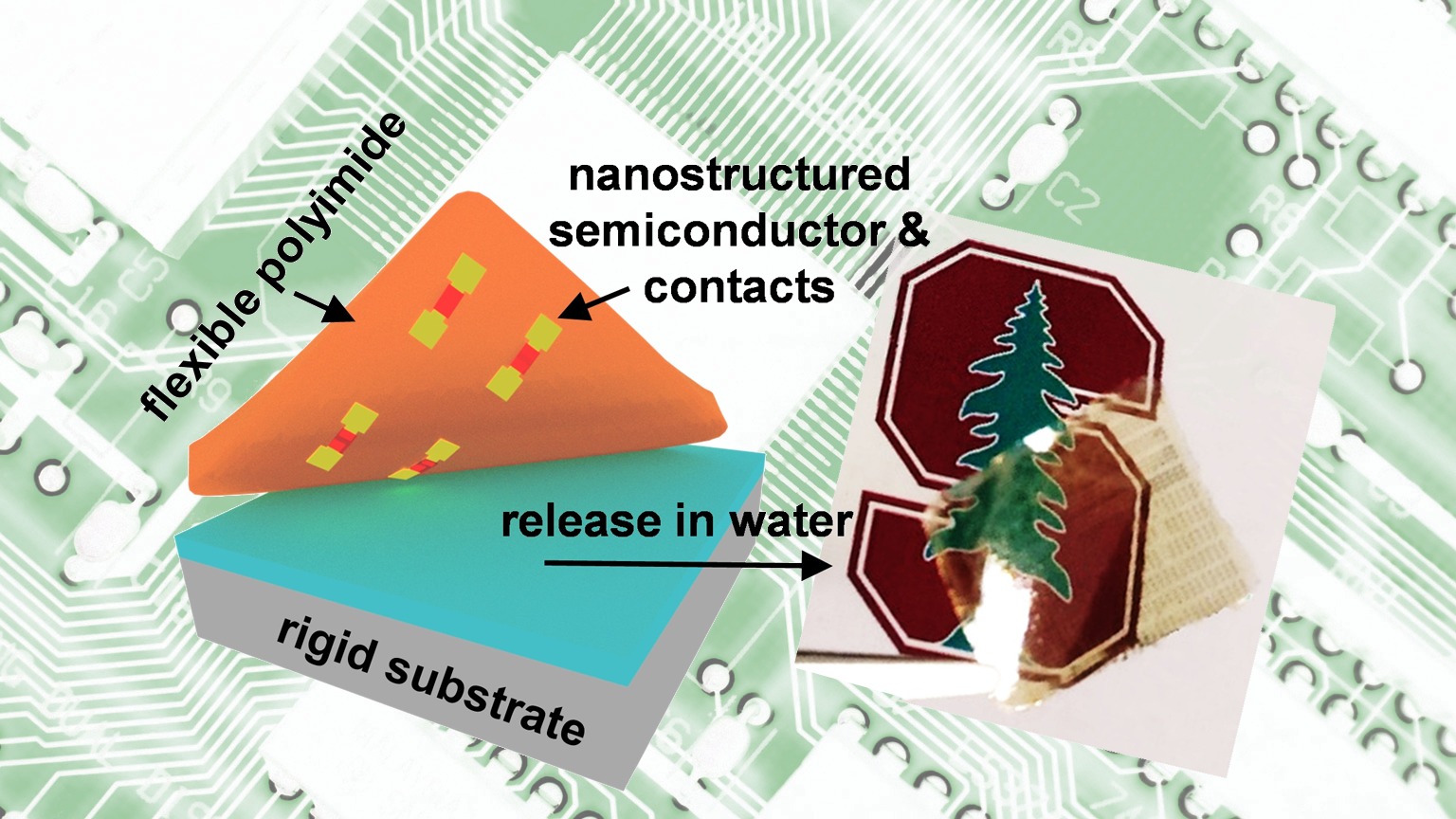

Now, researchers at Stanford University have devised a manufacturing approach that yields flexible, atomically thin transistors less than 100 nm in length—several times smaller than previously possible. Their solution is counterintuitive: They perform the process in a sequence of steps that starts with a rigid base substrate of silicon coated with glass (Fig. 1).
1. Transfer process for 2D monolayers with contacts: (a) Optical image of MoS2 and patterned metal covered by polyimide (PI) on SiO2/Si. (b) Schematic of the transfer process: the PI with embedded metal contacts and monolayer transition metal dichalcogenides (TMDs) are released from the rigid growth substrate. (c) Optical image of the flexible PI after transfer. Optical microscope images of (d), the SiO2/Si growth substrate after transfer (with the bare SiO2 surface where MoS2 had previously been covered by PI). (e) PI film with contacts and unpatterned MoS2 after transfer and (f) contacts with patterned MoS2 on SiO2/Si (top) and PI (bottom).
Next, they form an atomically thin film of the 2D semiconductor molybdenum disulfide (MoS2), one layer of atoms at a time, using chemical-vapor-deposition (CVD) techniques. Then it’s overlaid with small nano-patterned gold electrodes. While the resulting film is just three atoms thick, it still requires temperatures as high as 850°C to work. The traditional polyimide flexible substrate loses its shape at around 360°C and would be completely decomposed at those higher temperatures.
After first patterning and forming of these critical parts on rigid silicon and allowing them to cool, the Stanford researchers begin the process of applying it to the flexible material. Following a basic bath in deionized water, they peel back the entire device stack without damage and then fully transfer it to the flexible polyimide. Then a few additional fabrication steps complete the process.
“In the end, the entire structure is just 5 microns thick, including the flexible polyimide,” noted electrical engineering professor (and project leader) Eric Pop, commenting on this technique developed by Alwin Daus, a postdoctoral scholar in Pop’s lab.
