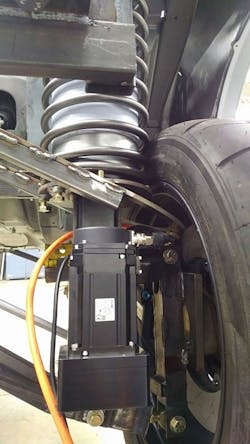

By now, Lin had a list of critical features for the actuators. First, they had to be powerful and quick. Next, they had to fit in the space inside the suspension’s coil spring normally occupied by shock absorbers. They also had to be programmable and be reliable with little or no maintenance needed. After a thorough search, Lin selected RSA electric rod-style actuators with roller-screws from Tolomatic.
The electric actuators are small enough to fit in the same space normally occupied by the Demon’s shock absorbers.
