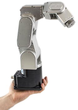

The Meca500—only half the size of a regular industrial robot—has six degrees of freedom . The robot is so small and light that it fits in the palm of your hands.
Three years later, Bonev and Coulombe designed the Meca500—a robot arm with six degrees of freedom and only half the size of a regular industrial robot. It weighs a mere five kilograms (11 pounds) and the base is about the size of your palm. Nevertheless, it has a load capacity of 500 grams, which is the equivalent to a stack of 200 pennies. The controller is integrated into the base, saving even more space and drastically simplifying operation. It only takes a 24-V power supply, a computer, and an Ethernet cable to program and operate the Meca500. Below is a video demonstration of the Meca500:
