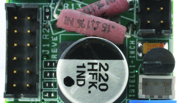

The stopper actuators consist of a custom stepper motor with a leadscrew and round-shaft bearing, plus an AllMotion Intelli-Inch stepper controller and driver. It also has a linear shaft with an antirotate feature. The controller/driver generates up to 25,000 pulses/sec and is programmed to run the motor a fixed number of steps clockwise or counterclockwise. At the end of travel, the motor simply stalls.
The actuator extends (and retracts) 11 mm in 0.5 sec to stop and release 10-tray pileups that push on the cantilevered actuator arm with about 15 lb of sideload. Besides its use in new conveyor machinery, the actuator is a drop-in replacement for pneumatic and solenoid stoppers on older machines.
Its electrical interface is similar to that for a solenoid: Wire inputs include Step, Direction, Ground, and Power, and two onboard potentiometers set Move and Hold currents.
