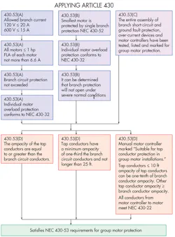

Figure 430-1 of the NEC provides a graphical representation of how to apply Article 430.

Article 430.53 specifies the requirements for protecting multiple motors on a single branch circuit. It is divided into four sections, sometimes referred to as 430.53(A), 430.53(B), etc. For simplicity, we’ll refer to these as sections A, B, C and D.
In all sections of Article 430, the NEC uses two similar but not identical terms when discussing motor current: Full-load amps (FLA) and full-load current (FLC). FLA is the motor’s full-load amperage at rated load and voltage. This number is stamped on the nameplate and should be used for sizing overload protection for the motor.
But Article 430.6(A) (1) dictates FLC be used for most calculations that size conductors or overcurrent protective devices. (Note there are a few exceptions for nonstandard applications.) Of course, there are a variety of motor types and designs available. Consequently, the NEC created tables [430.247 through 430.250] of FLC values large enough to represent worst-case scenarios.
Article 430.53 demonstrates three paths to protect multiple motors in a single installation: Section A, Section B or Section C. All installations must meet the requirements in one of these sections, and each installation must adhere to the requirements of section D which covers conductor sizing.

Section C covers multiple motors with listed components. It is the section most installations follow because it is flexible as to the number of motors and their sizes. Section C demands that all branch short-circuit and ground-fault protection devices, overcurrent devices, and motor controllers be UL tested, listed, and marked for group motor protection. That includes motor overload devices and controllers with a fuse or inverse-time circuit breaker, or both. The entire assembly doesn’t comply if one component isn’t listed.

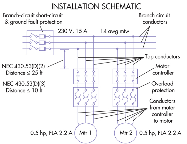

Section D covers conductor sizing for group motor installations. Designers have a choice among sections A, B, and C when selecting motor group protection, but Section D, on the other hand, is mandatory for all installations. Section D requires that all conductors from the controller to the motor meet NEC Article 430.22 standards by being sized to at least 125% of the smallest motor’s FLC. In addition, the requirements of NEC Article 430.32 (individual overload protection per motor) also apply for all branch circuits, regardless how many motors they feed. Finally, as with all tap conductors, the conductors must be protected from physical damage by enclosures, conduits or similar means.
Section D also dictates that only one of the following three requirements be met: The ampacity of the tap conductors are equal to or greater than the ampacity of the branch-circuit conductors; The tap conductors have a minimum ampacity of one-third that of the branch-circuit conductors and are no longer than 25 ft; or a manual motor controller may be used if it is marked “Suitable for Tap Conductor Protection in Group Motor Installations.” In this case, the following must apply: Tap conductors supplying the controller that are less than 10-ft long must have at least one-tenth the ampacity of the branch circuit device setting. Tap conductors longer than 10 ft must have an ampacity equal to or greater than the branch ampacity.
For example, suppose an OEM is designing a new packaging machine for a manufacturing process. Two motors will control a conveying operation and a cutting operation. Both are 1 hp, 230‑V, three-phase squirrel-cage motors with 1.0 service factors. The designer begins by using NEC Article 430.53 to determine which section (A, B or C) applies. In this case the designs will satisfy all the requirements of Section A. From 430.52 and 310.16, the branch circuit is a 15-A Class CC fuse feeding 14-AWG MTW wire because: All motors are rated 1 hp or less; the FLC of each motor does not exceed 6 A (table 430.250 dictates 4.2 A); the installation doesn’t exceed the ratings of the branch-circuit, short-circuit, and ground-fault protection device; and individual motor overload protection is set at 115% (4.8 A) per NEC 430.32(B)(1).
Now the designer must determine if the machine meets the requirements of Section D. The motor group protection requirements are that: The branch circuit is protected with a Class CC fuse rated at 15 A [430.52]; the main branch conductors are 14-AWG MTW wire, which is rated for 15 A [240.4(D)(3)]; and the tap conductors are 18-AWG MTW wire, which meet conditions in Section D(2) as described above are rated at 7 A [240.4(E)(6)].
The last item to verify is the size of the conductor running from the controller to the motor. Section 430.22 requires that conductors have an ampacity of at least 125% of the motor FLC. In this example the conductor is (4.2 × 125% ) = 5.25 A. The 18-AWG MTW wire is rated for 7 A [240.4(D)(1)], so the installation complies.
