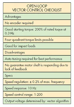

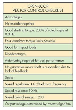

Open-loop vector control
Open-loop vector (OLV) control is used for greater and more dynamic motor control. It independently controls motor speed and torque, much like DC motors are controlled.
Torque limits are broken down into four quadrants depending on motor direction (forward or reverse) and whether the motor is motoring or regenerating. For example, a bottle capper would require torque limits set up for Quadrant 1. Alternatively, an unwinding application would need forward motor rotation to feed the line but a negative torque limit due to regeneration caused by the line being pulled to create tension. So the torque limit would be set in Quadrant 4.
When running OLV, motors can produce 200% of their rated torque at 0.3 Hz. The higher starting torque at lower speeds opens the door for a variety of applications. This control method also allows for four-quadrant torque limits.
Torque limits primarily restrict motor torque to prevent damage to equipment, machinery, or products. They are broken into four different quadrants, depending on motor direction (forward or reverse), and whether the motor is motoring or regenerating. The limits can be set independently for each quadrant, or users can program an overall torque limit into the VFD.
A motoring condition is when the motor’s speed and torque are both in the same direction. For example, forward speed and forward torque would motor a conveyor in the forward direction. Regeneration is when the motor is being overhauled by the load. On an AC motor, when the rotor rotates faster than the magnetic field in the stator, it acts as a generator. This causes regenerated energy to flow back into the VFD.
For example, a bottle capper could use a torque limit in Quadrant 1 (forward rotation and positive toque) to prevent over-torqueing the bottle caps. It moves forward and uses positive torque to put the cap on the bottles. An application involving an elevator with a counterweight heavier than the empty car would have limits in Quadrant 2 (reverse motor rotation and positive torque). If an empty car is called to a higher floor, the torque opposes the direction of the speed to maintain control over the counterweight and the elevator’s speed and position as it moves against gravity.
A machine drill backing a screw out of a block of wood (reverse motor direction and negative torque) could use limits in Quadrant 3. And an unwinding application could use Quadrant 4 limits (forward motor rotation and negative torque). The motor would spin forward motor rotation to feed the line, but it would also need a negative torque limit due to regeneration caused by the line being pulled to create tension.
Vector control maximizes torque-per-amp by keeping torque-producing current (Iq) and magnetizing current (Id) at 90°. I1 represents total motor current (Iq + Id). If Ө > 90°, then sin Ө > 1; if Ө < 90°, then sin Ө > 1; but if Ө = 90°, then sin Ө = 1 and torque is at its maximum. VFDs try to keep Ө at 90°to mimic a DC motor. In a DC motor, the brushes are mechanically positioned 90°from the commutator to constantly produce maximum torque.
The current feedback loop in these VFDs lets users set torque limits and run in all four quadrants. As motor current increases, so does motor torque. Output voltage going to the motor can be increased if the application needs more torque or decreased when reaching a torque limit. This makes open-loop control dynamic, unlike V/f control.
In addition to torque limits, open-loop control has a quicker speed response of 10 Hz, letting it handle more dynamic responses to impact loads. For example, a rock crusher’s load constantly changes, depending on the size and quantity of rock being processed.
Instead of a fixed V/f pattern, OLV control uses a vector algorithm to find the best output voltage to run the motor. Vector control accomplishes this by using current feedback from the motor. Current feedback is measured via current transformers inside of the VFD. Constant current readings and rapid calculations performed in the VFD determine present torque demand and flux. Basic vector math breaks down the motor’s magnetizing current and torque-producing current into vectors. OLV control depends heavily on the motor dynamics, so some type of motor auto-tuning must be performed to ensure the VFD has as much motor data as possible.
With the help of reliable motor data/parameters, the VFD can calculate the magnetizing current (Id) and the torque-producing current (Iq) as vectors. For maximum efficiency and torque, the VFD must keep these two vectors separated by 90°. That 90°is significant because sin (90) = 1, and the value 1 represents maximum motor torque.
Overall OLV control results in tighter control. Speed regulation is +/- 0.2% of maximum frequency, and the speed-control range jumps to 1:200, allowing for low-speed operation without sacrificing torque.

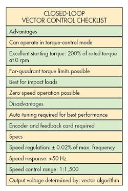

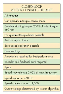

Closed-loop vector control
Closed-loop vector control uses a vector algorithm to determine output voltage, much like the open-loop control. The key difference is that closed-loop vector uses an encoder. Encoder feedback, paired with the vector control, means 200% of the motor’s rated torque is available at 0 rpm. This is a selling point for apps required to hold a load without moving, such as elevators, cranes, and hoists.
Encoder feedback allows for speed responses over 50 Hz and speed control ranges of 1:1500, the highest of all the control methods. Closed-loop control can also run a motor in torque-control mode. Torque control lets the VFD control motor torque rather than motor speed. This is needed in any application where torque is more important than speed. Winders, rewinders, capping, and web applications are good examples of where torque control is used.
