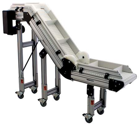

FlexLink Systems Inc., Allentown, Pa., developed enhancements for its X85 conveyor system, which boasts high line capacity with speeds up to 390 fpm. The wearguards have been beefed up to promote longer wear times. The thicker wear guards also make the conveyor quieter. Idler pulleys underwent a redesign to get the conveyor speed up. The conveyor also has a modified spring-loaded pin holding its chain together.
