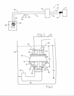

The NeoVent consists of an innovative oscillatory relief valve, and is driven by excess air generated by the CPAP machine. Air at a constant pressure is transported from the CPAP machine to the child’s airway via a tube. As shown in the patent sketch, the tube bifurcates, continuing past the airway to bring any excess air to the NeoVent.
Excess air from the CPAP machine is used to power the team's oscillatory relief valve, which generates positive and negative pressure for respiratory treatment in premature infants.
The tube is submerged into water to produce bubbles, which are caught in a small inverted bowl on the relief valve. Slits on top of the bowl are covered by a sleeve at the beginning of a cycle. The bin is free to rise a small distance on the submerged tube as it fills with bubbles. The upstroke supplies positive pressure to the child’s lungs. The bin fills with bubbles, and when it reaches its peak, the sleeve disengages. The bubbles are released, causing the bin to sink to the bottom again, pulling air out of the baby’s lungs. At the bottom, the sleeve re-engages and the bin fills with bubbles to repeat the cycle. Peak pressure is determined by the height of the water level.
