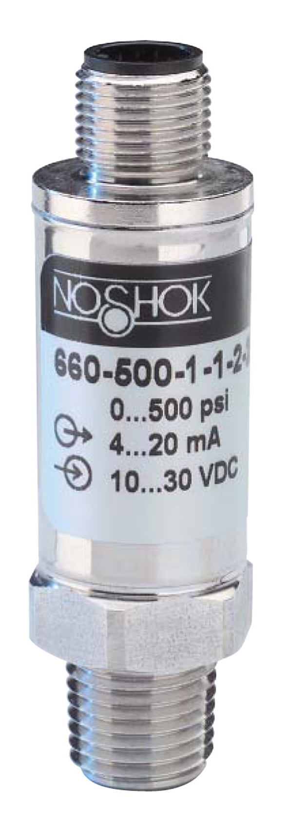

Noshok pressure transducers, designed to handle pressure spikes and process pulsation, feature a welded stainless-steel pressure chamber for strength and durability. Features of the transducers include up to ±0.25% full-scale accuracy, standard ranges from 200 to 15,000 psi, and a sputtered thin-film sensor that provides stainless-steel media compatibility and long-term measurement stability. Specifications include output signal: 4 to 20-mA two-wire, 1 to 5-Vdc three-wire; 0.1 to 10-Vdc, three-wire; ≤ ±0.05% full-scale repeatability; ≤ ±0.5% full-scale hysteresis; ≤ ±.2% full-scale stability for 1 year, nonaccumulating; and <2 msec (between 10 and 90% full-scale) response time.
