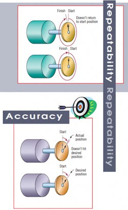

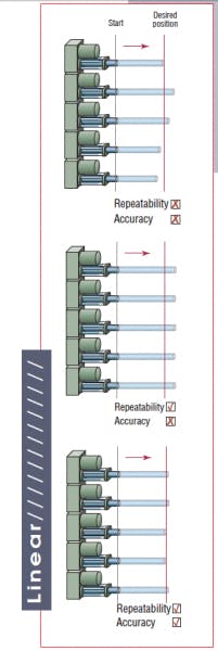

Instead of relating to a measurable quantity — like rpm or ips in the case of speed — precision is more the net result of several other variables, including resolution, accuracy, and repeatability.
Resolution is the smallest position increment achievable with a particular actuator. It can be linear or axial. In a digitally controlled system, resolution is the shortest specifiable move. It is influenced by every component in the actuation mechanism.
Accuracy is the maximum error between expected and actual position following a move. It too can be linear or axial, and it includes the effect of backlash and hysteresis.
Repeatability is a measure of how close a positioning system can return to a given starting point. To eliminate the effect of backlash and hysteresis, the actuator must approach the target position from the same direction, at the same speed and deceleration rate, and under the same load conditions.

Q: Is it possible for an actuator to be repeatable without being accurate?
A: Yes. An actuator can consistently miss its target by the same amount on each cycle.
