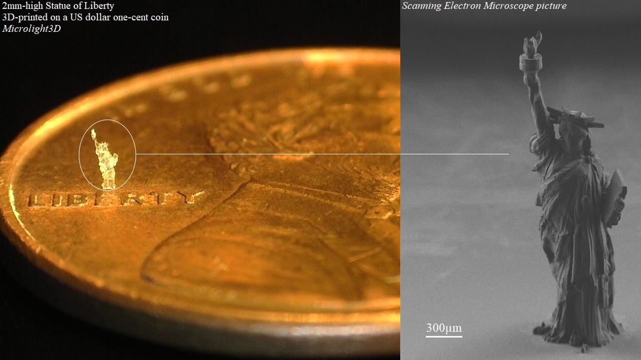

Microlight3D printed the world’s tiniest Statue of Liberty, a replica measuring 1.8 mm high by 0.6 mm wide, to commemorate Inauguration Day in the United States. The statue is a universal symbol of freedom and democracy and was a gift from the French in 1886 commemorating the alliance of France and the United States during the American Revolution.

Microlight3D, based in Grenoble, France, noted that the statue breaks the height limitation and demonstrates the ability to 3D print minute structures up to 10 mm high while maintaining micrometric resolution. Previously, the height of objects was limited to 0.3 mm.
The advancement is intended to address demands of researchers and industrial developers working on applications in mechanical micro-parts, meta-materials and medical devices. The company noted that users can make alignments on a preexisting pattern and print exactly where they want. The replica of the statue, for example, was positioned on the word “Liberty” on a U.S. penny.
Users can make alignments on a pre-existing pattern and print exactly where they want, noted the company. The replica of the statue, for example, was positioned on the word “Liberty” on a U.S. penny.
Philippe Paliard, co-founder of Microlight3D, said researchers and industrial developers are looking to work on metallic or silicon wafers. The company’s 3D microprinting system is compatible with a wide range of materials and substrates, he said, and allows users to micro-fabricate structures they couldn’t before. The µFAB3D-Advanced 3D microprinter can align the laser and print on the tip of optical fibers for micro-optics applications, said Paliard.

The statue was printed directly onto the coin to demonstrate compatibility with different printing substrates, notably metallic and opaque substrates.
Microlight3D’s technique is based on two-photon polymerization, consisting of a green pulsed laser (operating at 532 nanometers wavelength), which combined with ultra-precise moving stages creates 3D objects in a photoresist with sub-micron resolution. A simple solvent bath removes the unpolymerized resin.
