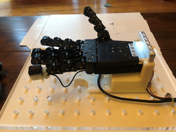

In an experimental study, scientists have made an in-depth comparison of an artificial fingertip with neural recordings of the human sense of touch. The findings, published in two papers in the Journal of the Royal Society Interface, describe the creation of an artificial biomimetic tactile sensor (the TacTip), which could provide artificial analogs of human skin dynamics and afferent responses. Simply stated, the artificial fingertip can mimic human nerve signals.
The researchers, who hail from the University of Bristol’s Department of Engineering Maths and are based at the Bristol Robotics Laboratory, created the artificial sense of touch using a 3D-printed mesh of papillae on the underside of the compliant skin. The construction is reminiscent of the skin’s dermal-epidermal interface backed by a mesh of “biomimetic intermediate ridges and dermal papillae, comprising inner pins tipped with markers,” noted the researchers.
The papillae were constructed on advanced 3D printers capable of missing soft and hard materials that emulate textures and effects found in human biology.
“Our work helps uncover how the complex internal structure of human skin creates our human sense of touch,” reported lead researcher Nathan Lepora, professor of robotics and AI. “This is an exciting development in the field of soft robotics—being able to 3D print tactile skin could create robots that are more dexterous or significantly improve the performance of prosthetic hands by giving them an in-built sense of touch.”
The University of Bristol noted that a 3D-printed tactile fingertip can produce artificial nerve signals that look like recordings from real, tactile neurons. “Human tactile nerves transmit signals from various nerve endings called mechanoreceptors, which can signal the pressure and shape of a contact,” said Lepora. “Classic work by Phillips and Johnson in 1981 first plotted electrical recordings from these nerves to study ‘tactile spatial resolution’ using a set of standard ridged shapes used by psychologists. In our work, we tested our 3D-printed artificial fingertip as it ‘felt’ those same ridged shapes and discovered a startlingly close match to the neural data.
“For me, the most exciting moment was when we looked at our artificial nerve recordings from the 3D-printed fingertip and they looked like the real recordings from over 40 years ago. Those recordings are very complex, with hills and dips over edges and ridges, and we saw the same pattern in our artificial tactile data.”
One area that needs refinement, according to the researchers, is the artificial fingertip’s sensitivity to fine detail. Lepora noted that the 3D-printed skin is thicker than real skin and and his team is exploring how to 3D print structures on the microscopic scale of human skin.
“Our aim is to make artificial skin as good—or even better—than real skin,” he said.
