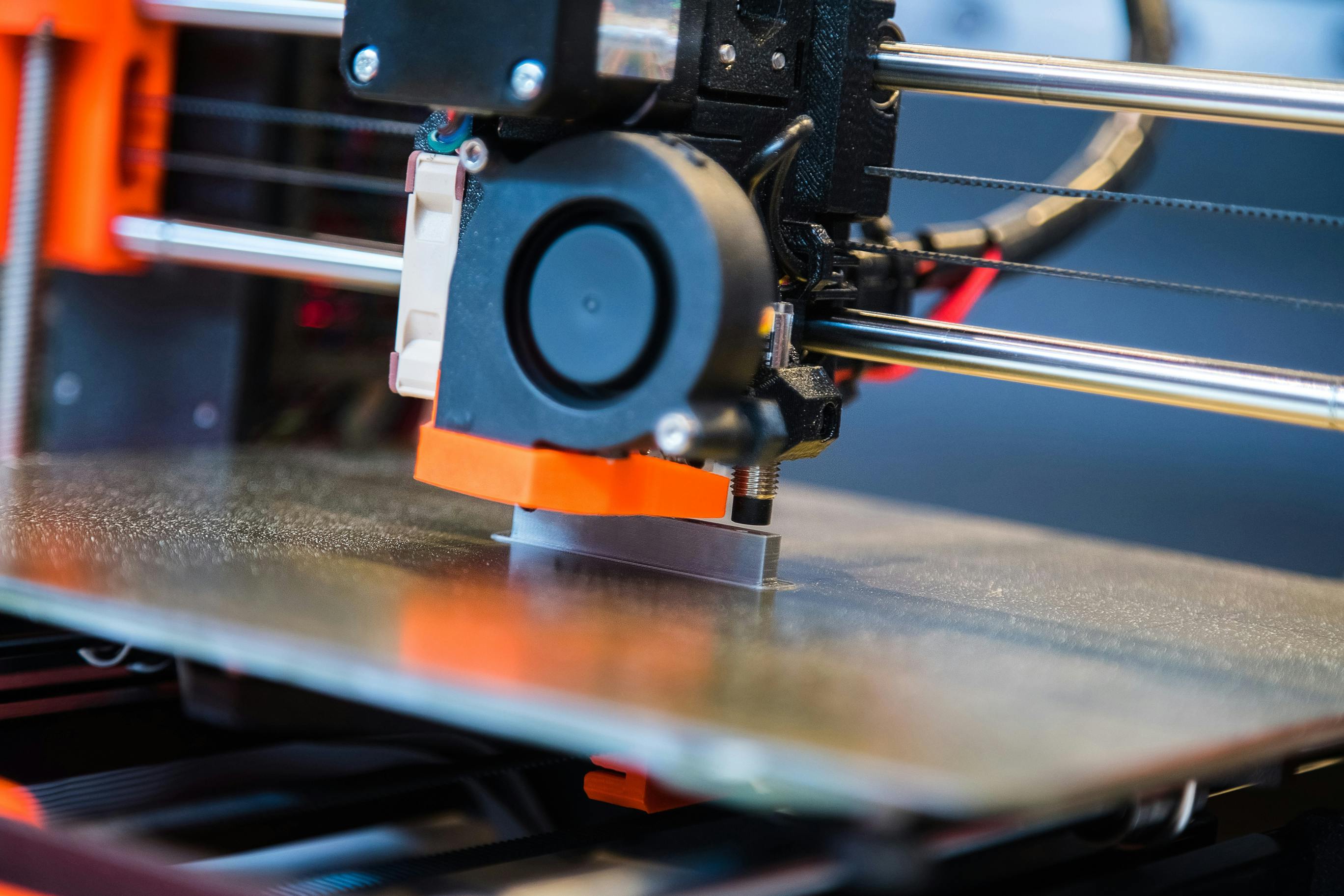

140388971 © JaCrispy | Dreamstime.com
3D printer in operation
