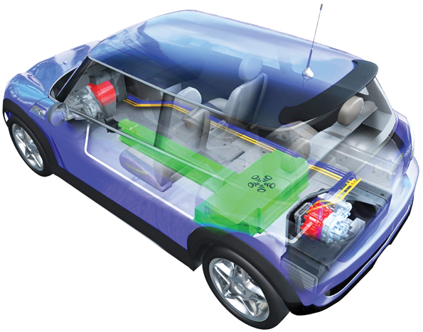

A Li-ion battery pack (green T-shaped arrangement) in an electric hybrid must maximize power capacity but fit into a tight space, making cooling and temperature controls more critical. In front of the generator (rear red), electronic controls (dark grey) constantly monitor all battery cells, commanding a reduction in battery-power draw (via the high-voltage harness, blue and yellow) if any cell overheats.
Most hybrid vehicles today use Li-ion batteries, but heat is a major challenge. If cells in a battery pack become too hot, controls often protect them from damage by taking the car off battery power and switching it to the combustion engine. So, in a recent R&D project to convert a gasoline-powered car into a range-extender hybrid, the simulation team at AVL North America Inc., Plymouth, Mich., designed a low-cost cooling system for a battery pack consisting of 14 off-the-shelf modules.
