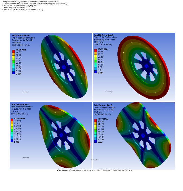

This is a three-dimensional FE model of the disc of dry friction clutch. Dry-friction clutches are the clutch of choice in passenger vehicles. Results of this simulation guide the redesign and manufacture of the clutch disc.
2. Built a three-dimensional model.    For example:
3. Next, apply boundary conditions.
4. Finally, review the results in a viewer to identify critical frequencies and mode shapes.
Shown above are the mode shapes of a sample clutch disc. The mode shapes have values:
ri = 0.085 m
ro = 0.135 m
tf = 0.002 m.
In fact, these simulation results recently helped engineers design a friction clutch disc suitable for a specific vehicle transmission.
