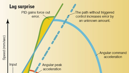

A change in process speed. When commanded to move, all servo systems initially do nothing. This is the servo lag present in all systems. Then the system starts to move.
Say a line of paper is going by at 3,000 ft/sec and at every 200 ft, we see a marker. Well, with a servo lag of 500 µsec we can expect 1.5 ft of error. Now 1.5 ft is a large error, but because it is a known, repeatable error, we can anticipate it, and live quite happily making perfectly good product. But what happens if line speed drops by half? Speed is then 1,500 ft/sec, but because lag time for the servo system is fixed at 500 µsec, expected error is now 0.75 ft or 9 in. The good news is that error is smaller than when the system was going faster; the bad news is that error is different by 9 full inches. The inability to compensate for this different, speed-induced error change exposes limitations caused by servo-system bandwidth.
How do triggered moves help?
By being fast. A high-speed hardware register records the input in a sub-microsecond timeframe, and then another register records when movement actually begins. The difference between the two is the time period that defines the period where the system should have been moving. Speed over a period of time equals position; system firmware quickly calculates error or unattainable position loss by looking at the commanded acceleration. Time t between input and actual motion and the commanded acceleration rate define the unattainable position error caused by lag. This position error is fed the high side of the comparator circuit, and then — after comparison to feedback — is sent as raw error to the position loop. The position loop gains aggressively eliminate this (and all other errors) from the system.
Now, this seems fairly straightforward, but only firmware hardware can make these calculations fast enough. Solving this math and then making an input to servo command over software takes far too much time. Why? Total acceleration time is typically less than half a second. So, hardware registers must be sub-microsecond, and response sub-millisecond, to make calculations based on hard numbers, and give repeatable results. Otherwise, the system would just take the dotted blue path (see left) without registering any of the non-repeatable error.
