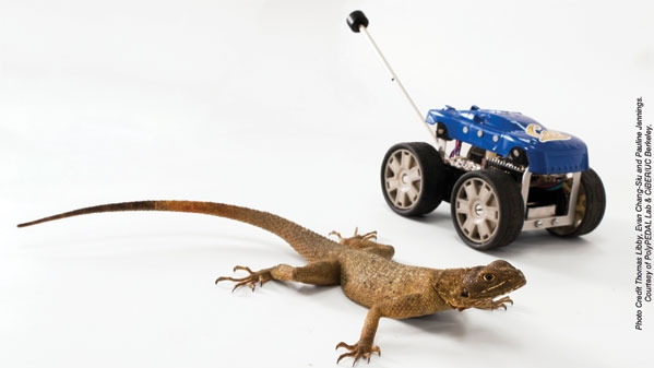

High-speed videography, mathematical modeling, and prototyping are helping researchers recreate lizard-righting motion and pendulum-type maneuvers in robotics. One recent study carried out by Ardian Jusufi and colleagues at the University of California, Berkeley, demonstrates how large-tailed animals avoid injury by flipping to land on their feet.
“It is not immediately obvious which mechanism an animal will use to accomplish aerial righting. Depending on body size, morphology, and mass distribution, there are multiple strategies,” says Jusufi.
The robot used to verify 3D righting-motion models consists of body and tail, plus a gyroscope that senses body position and sends feedback to a tail-positioning motor. This control effectively transfers angular momentum from body to tail.
