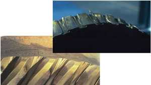

Gearing disaster zone
What's the worst that can happen if a gear is not specified or installed correctly?
Chuck • Baldor: One of the worst things that can happen to a production facility is premature gear reducer failure. This can cause a shutdown of production equipment, which could affect an entire facility.
Brian • QTC: The worst thing that can happen is that the entire assembly fails. A spur gear that has its teeth stripped off can cause a million dollar piece of equipment to suddenly become idle. When a gear is improperly installed, the machine in which it is operating will continue to work for a period of time. As the old saying goes, “If you can't find ‘em, grind ‘em.” This is what happens until the teeth are worn to a point were the machine fails.
