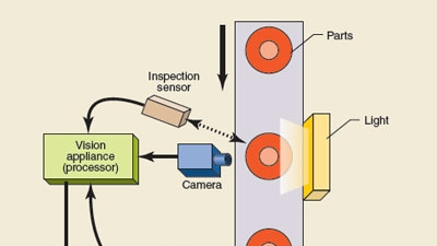

Because of this commonality, examining a specific application such as inspecting objects on an assembly line will help illustrate the method by which developers can build a suitable machine vision system.
Essential elements of an inspection system include a delivery vehicle, vision system, response system, and sensors to trigger image capture and system response. The delivery vehicle positions the object for inspection. The vision system (camera, optics, lighting, and image processor) captures and processes the object image to determine a pass/fail response. The response system takes the required action and communicates results to operators or other systems. Sensors trigger the vision and response systems, identifying when the object is positioned properly for the systems to perform their tasks.
A first step in developing an inspection system is to determine how parts are to be placed in front of the camera. In this example, the delivery vehicle is a conveyer belt that carries objects past the vision system at a constant speed. Other delivery vehicles include part feeders, robotic arms, or a human placing an object in a station for inspections. Choosing a delivery system is often the hardest part of a factory automation design because it places restrictions on the remaining system choices.
Next, developers must determine the most appropriate method for triggering the vision system (to capture the image) as well as the response (to take action). In the case of conveyer belt delivery, an appropriate sensor might be electronic photo-eyes that produce a signal when an object passes between them. With other delivery vehicles, sensors such as proximity switches or programmable limit switches could work.
Image capture, processing, and results evaluation are tasks for the vision system, which determines if the object being inspected is within acceptable quality tolerances and then tells the response system what to do. A separate vision controller such as a vision appliance may handle the image processing, or those functions may be integrated into a smart camera.
Parameters to be evaluated and object characteristics will influence the choice of camera, optics, lighting, and image processing software. For example, reading an identification number requires close-up imaging, front lighting, and optical character recognition software. Inspecting the fill level in a soda bottle requires back lighting and the ability to detect the position of the liquid's surface.
The final step is to define how the system will respond to its decisions. In this example, the vision controller triggers a PLC to push rejected parts off the conveyer to another delivery system, allowing acceptable parts to continue undisturbed. The controller may also send decision results to higher level networks for quality control and traceability purposes.
