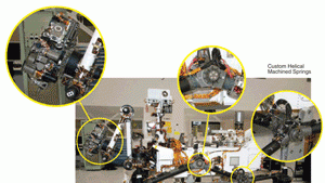

Helical Products Company Inc., Santa Maria, Calif., has several parts aboard Curiosity. The company's engineering team designed and manufactured flexible couplings and machined springs for NASA's Jet Propulsion Laboratory (JPL), working closely with JPL's engineers on the ultra-precise designs. Flexible couplings will be used in the vibration mechanism within the Sample Acquisition and Sample Processing and Handling (SASPaH) subsystem at the end of the rover's robotic arm. This system, located at the front of the rover, will gather soil samples from the planet's rocky surface. Vibration, aided by the flexible coupling, will be used to pass soil through sifters and ultimately through the sampling system. From there, particles will be processed and examined by the rover's analytical instruments.
Curiosity is also equipped with several of Helical's machined springs, which will be used as a locking latch in the hinge mechanism. Once the rover is deployed, the hinge rotates and the latch locks it in place.
Helical designed the spring to meet NASA's specifications regarding compression and lateral translation spring rates, end attachments, and lightweight titanium material. Helical's parts can also be found on the International Space Station and Hubble Space Telescope. For more information, visit heli-cal.com.
