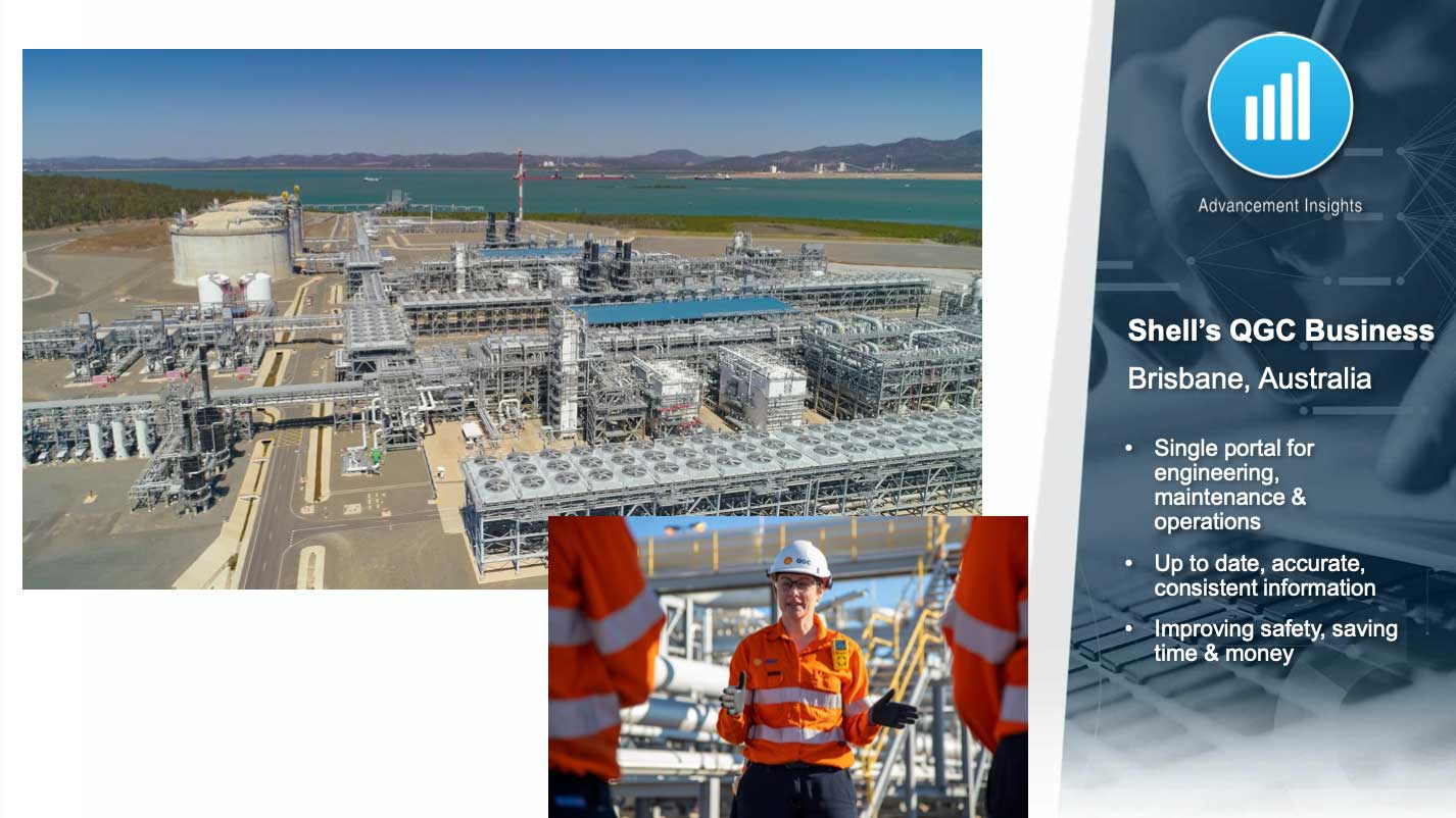

The first was Shell’s QGC Business, an Australian natural gas producer with more than 2,600 wells, 24 compression stations, six processing plants, two water treatment plants and a two-train LNG export facility. The facility established a master tag registry, storing more than 20 million data points using their Azure cloud-based engineering data warehouse powered by Bentley’s AssetWise ALIM.
Shell QGC reduced tag capture time by 90%, strengthened collaboration, enhanced transparency and improved safety. (Shell’s QGC Business was named the winner in the Utilities and Industrial Asset Performance category at the YII20 Awards ceremony on October 19.)
