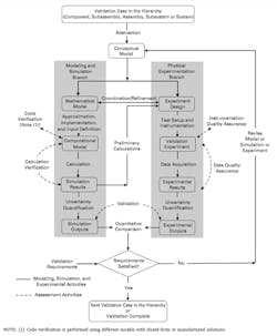

Achieving Simulation Credibility in Analysis of an Aircraft Structure
The following example from the aviation industry shows how the concepts from the currently published ASME standards are applied and involve input from different users or stakeholders such as engineers, scientists, analysts, experimenters, programmers, managers, decision-makers and regulators. The example begins with the Validation Case diagram from the V&V 10 Standard on Computational Solid Mechanics and walks through the process steps to be followed for analyzing an aircraft’s structure.
An aircraft’s structure is to be analyzed under conditions such as static loadings to determine optimum design and risks (e.g., fatigue). A hierarchical approach may be used to first investigate a component of the aircraft such as the wing before the higher-level subsystems are analyzed so as not to miss detailed processes occurring at these lower-level components. A model of the wing is developed in three parts (conceptual, mathematical, computational):
The conceptual model is defined to represent the basic structure of the wing. For this case, a wing can be represented by a tapered cantilever beam.
The mathematical model is defined to represent the equations that govern the behavior of the beam representing the wing. For this case, equations including force, moment, stress and deflection with boundary conditions at the fixed and free ends comprise the mathematical model.
The computational model is defined as the discretized form of the mathematical model so that it can be analyzed using a computer (e.g., Finite Element Analysis).
After model development, a user is to perform code verification to determine if the computational model is performing as expected and that there are no “bugs” in the code. Code verification involves testing the code output against exact analytical solutions that are already known for the cantilever beam model under specific loading conditions. Following code verification, calculation verification (solution verification) is performed and involves estimating the error in putting the equations for the cantilever beam in approximate or discretized form.
After obtaining simulation results, the user is to perform validation to determine how well the simulation results compare to empirical data, which can be obtained from sources including experiments. Performing uncertainty quantification is important for assessing how sources of uncertainty in modeling and simulation, experimentation or the real-world system affect the final output.
For instance, should any adjustments be made to the cantilever beam model to better represent the physical system and reduce uncertainty? If needed, the analysis is to be repeated with potential modifications to the model or experiment before analyzing the next (higher) level in the hierarchy.
