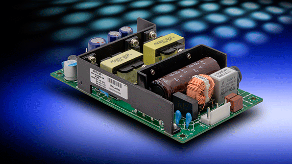

TDK Lambda’s CUT75 low-profile, triple-output power supplies, measuring 3 by 5 by 1.06 in., will fit numerous industrial, broadcast, and test-and-measurement applications. Input voltage from 85 to 265 VAC is required for the two standard models; both produce 75-W output power. The CUT75-522 features a 5-V ±12-V output voltage, while and the CUT75-5FF has a 5-V, ±15-V output. Units can be configured as dual-output power supplies (5 V ±24 V, or 5 V ±30 V) by connecting outputs 2 and 3 in series.
There’s no minimum load operation.  The 5-V output is user adjustable from 5 to 5.25 V.  The series features an operating temperature range from –20 to 70oC ambient (with appropriate de-rating above 60 oC), and carries a three-year warranty.
