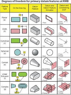

The degrees-of-freedom concept has been introduced recognizing that a part has six degrees of freedom, three translations, and three rotations. These degrees of freedom must be constrained to mathematically apply or measure geometric tolerances. The degrees of freedom approach in establishing a datum-reference frame is not new, it was first introduced in the ASME Y14.5.1-1994 standard and is now a staple of the new ASME Y14.5-2009 standard.
A degrees-of-freedom table has been added to the datum section. This table identifies primary datum features regardless of material boundary. The table describes the theoretical succession of events beginning with the identification of a datum feature on a drawing, its related datum feature simulator, the datum it establishes, and the degrees of freedom it constrains. This enhancement allows any feature to become a datum feature.
As a result of allowing any feature to become a datum feature, datum-feature modifiers have been expanded using new datum-feature modifier terms such as Maximum Material Boundary (MMB), Least Material Boundary (LMB), and Regardless of Material Boundary (RMB). These new terms replace the datum feature modifiers Maximum Material Condition (MMC), Least Material Condition (LMC), and Regardless of Feature Size (RFS).
