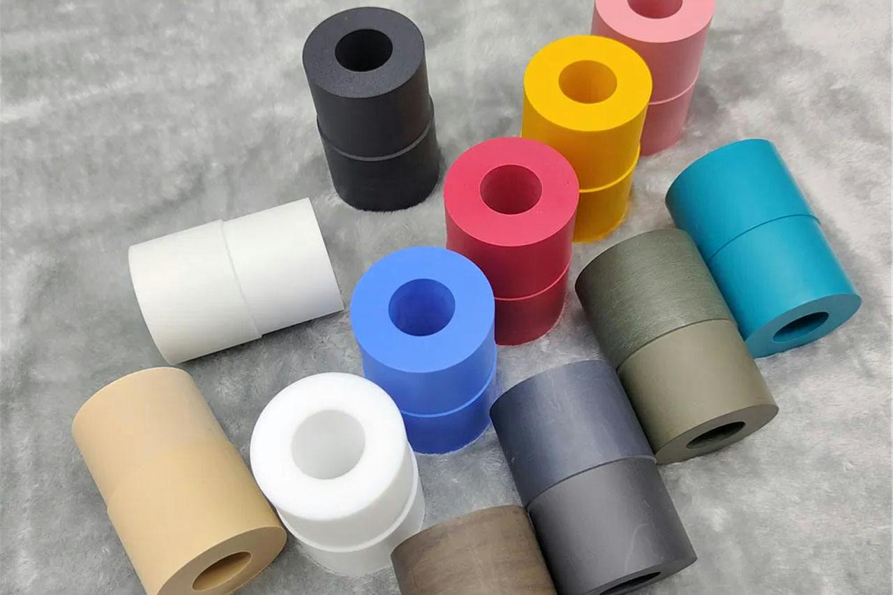

A sleeve bushing is often represented by three dimensions: inside diameter, outside diameter and length. That geometry may be enough to create a CAD feature, but it is rarely enough to define a functional polymer bearing. A supplier still has to determine what the bore mates with, how the outside diameter is retained, which loads act on the part, what the environment does to the material and which characteristics must be verified. If those inputs are absent, the quotation may be based on assumptions that do not match the design.
