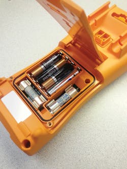

Examine the way inexpensive meter cases are assembled and you’ll typically find the case halves held together with self-tapping screws. The problem is that batteries and fuses are in the case. Repeated entries to service them can become tedious. High-end devices, such as the Agilent U1273A, use a separate battery door that is O-ring gasketed and fastened with machine screws. This sort of attachment technique gives the device an IP54 rating for dusty and wet industrial environments. Few meters go this far.

Industrial meters such as the Agilent U1273A may provide access to batteries and fuses through a special battery door. It is not uncommon that inexpensive meters force the user to completely disassemble the case as a means of accessing the batteries and fuses.

When configured properly, the HHDMM has a high input impedance that will block the high-energy voltage for safe testing. And in meters like the U1273A, one can see two specialty fuses behind the battery door, each protecting one of the two ampere jacks. Fuse makers actually designed special fuses just for this task. The fuses are small enough to fit inside an HHDMM but are capable of interrupting high-energy arc-flash fault current over 10,000 A. These fuses are special and expensive. There are no cheap import substitutes for them. Hobbyist HHDMMs do not offer such protection. That’s why inexpensive hobbyist HHDMMs should never be brought into industrial environments.
