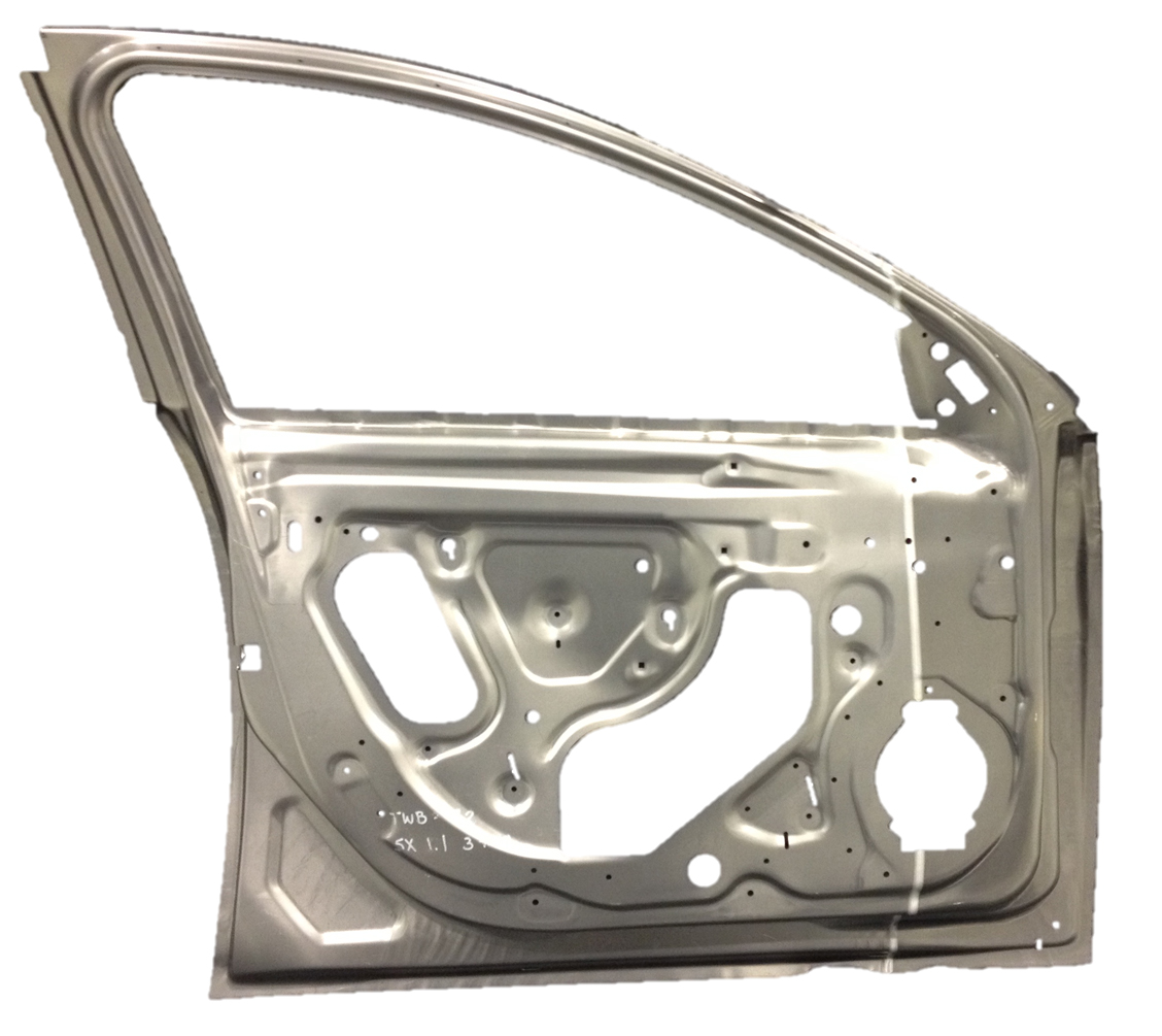

In a test, the updated FSW process was used to join two sheets of aluminum, one much thicker than the other. The joined sheet was then stamped into a car door. This FSW was quicker and less expensive than conventional manufacturing methods and turned out a door that was 62% lighter and costs 25% less.
