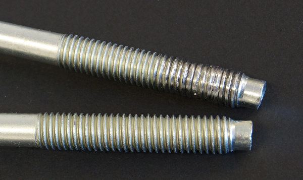

Getting the best fastener can often be an afterthought on a major design project, and this can lead to problems. For example, a Fortune 500 manufacturer of medium- and heavy-duty trucks were having problems with trucks coming off a new assembly line. The company isolated the problem to the fasteners used to attach the diesel exhaust fluid tanks onto the truck’s frame. The fasteners were galling, a form of wear in which metal parts slide against one another and create stress. Although designers had included locking fasteners to manage the constant vibrations in the joint, they did not address the possibility of galling.

Engineers from Optimas and the truck maker analyzed the bolt straightness, the plating type, and the design and location of the patch, to better understand the fastener function, where it was failing and how to optimize it.
As a result, Optimas helped redesign the fastener. They reduced the length of the threaded component, moving from a fully-threaded design to a partially threaded one. Most of the load on a threaded fastener is carried by the screw’s first few threads. A fully-threaded fastened does not add any benefit in terms of performance, but it does add more friction which contributes to galling.
Optimas also applied an anti-galling plating, zinc trivalent clear plus seal plating. They also substituted the hard lock patches for FCT-360 soft nylon ones. Hard and soft patches tend to differ in their adhesive strengths. Hard ones have higher anti-vibration characteristics that prevent joints from loosening but can cause galling. Soft ones might create a less powerfully locked assembly but reduce friction galling. In this case, the soft patch lowered friction yet still provided the same anti-vibration properties as the hard patch.
