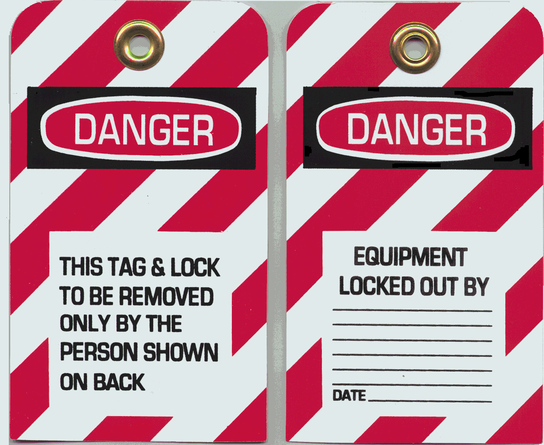

A lock out tag caries a warning not to remove the tag and start the machine, along with information on who locked out the machine and why.

OSHA created the lockout/tagout (LO/TO) standard to reduce the number of workplace injuries and fatalities. As defined by OSHA 1910.147(a) (1) (i), LO/TO refers to “specific practices and procedures to safeguard employees from the unexpected energization or startup of machinery and equipment, or the release of hazardous energy during service or maintenance activities.”
In practice, it requires an operator or maintenance worker to turn off the machine, activate all energy-isolating devices, dissipate or release all energy stored in the machine, and place a tag on the machine identifying why the machine is locked out and who did it, along with a lock that prevents the machine from being turned on. The worker secures the lock and keeps the key until he completes the work.
