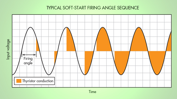

A soft starter has thyristors in its main circuit by which it adjusts motor voltage.

The idea behind a soft start is to gradually allow the motor current to rise until the motor reaches its steady state. This reduces start-up current but also reduces start-up motor torque. Soft starters adjust motor voltage through use of back-to-back thyristors or triacs in each ac supply line to the motor. The thyristors are actuated during the start-up phase such that their turn-on is successively delayed less for each ac half cycle. The delayed switching effectively ramps up the average ac voltage to the motor until the motor sees full line voltage. Once the motor hits its rated speed, the thyristor switching circuit may be bypassed. Larger motors employ either soft starters or they are controlled by variable-frequency drives that incorporate a soft-start function.

Thyristors in a soft starter let part of the voltage through at the beginning of the starting sequence and gradually increase it according to the set ramp time. The thyristors can also typically implement a soft stop by reducing motor voltage according to a set ramp time.
