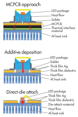

Circuit boards and substrates for LED mounting get scrutiny for thermal properties as well. Bruijnis says its customers are using both thermal-clad boards such as metal-core PCBs (MCPCBs) and ordinary FR4 boards. “FR4 can still be used when the power densities aren’t quite as high, though the FR4 board will often incorporate thermal vias to reduce the board thermal impedance,” he says.
MCPCBs used with higher-power LEDs incorporate a base metal, usually an aluminum or copper alloy, that acts as a heat spreader. Covering the metal is a dielectric polymer layer optimized to conduct heat. Another widely used substrate material consists of aluminum onto which a thick-film dielectric is deposited where needed. The resulting additive-deposition process is said to provide a more direct connection to the aluminum heat sink. One such system, called Heraeus Celcion, is said to reduce the junction temperature of the LED by up to 10°C below that seen on MCPCBs.

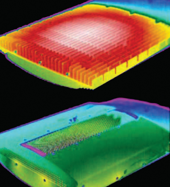

“The main trend we’re seeing right now is a cost-reduction effort on the thermal design that often means taking out the active cooling where possible,” says Bergquist’s Bruijnis. Still, it’s likely that luminaires for high-brightness LEDs will continue to incorporate active cooling such as fans for some time to come. One approach fan makers now employ is to make fans in form factors specific to widely used LED module standards. An example comes from fan maker ebm-papst Inc., Farmington, Conn. It makes fans designed with integral heat sinks that fit directly onto LED modules from light supplier Xicato, San Jose. These are axial fans that use brushless-dc motors that consume 180 mW at most.
One way to eliminate active cooling of LED modules is to employ more-clever heat sinking. Sometimes that task involves use of heat-sinking material that is on the exotic side. An example is heat-sink material based on graphite, developed by GrafTech International, Parma, Ohio. Called Spreadershield, it has a thermal conductivity that can be engineered to reach 1,500 W/m‑K, a level better than that of copper and aluminum. It is also flexible enough to conform to package contours and can have a minimum thickness of 0.05 mm (0.002 in.). Moreover, it is 80% lighter than copper and 30% lighter than aluminum.
