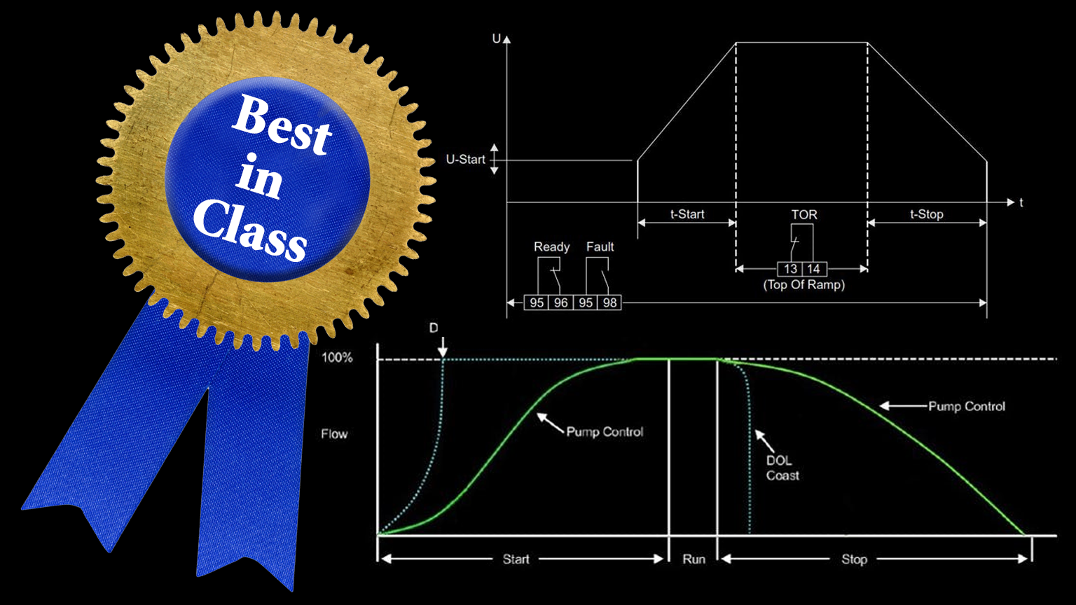

Soft starters or reduced voltage soft starters (RVSSs) can be added to typical 3-phase AC motors to reduce strain on the motors during typical power-up phases by limiting motor torque and the initial inrush of current. This is done by controlled solid-state switches for each phase that gradually ramp up the initial voltage to the motor and generate so called “soft starts.”

  • Eliminate water hammer by imposing an S-curve profile on the start and stop the pump, which also extends the life of the equipment. Water hammer can rattle plumbing and lead to catastrophic component failure.
