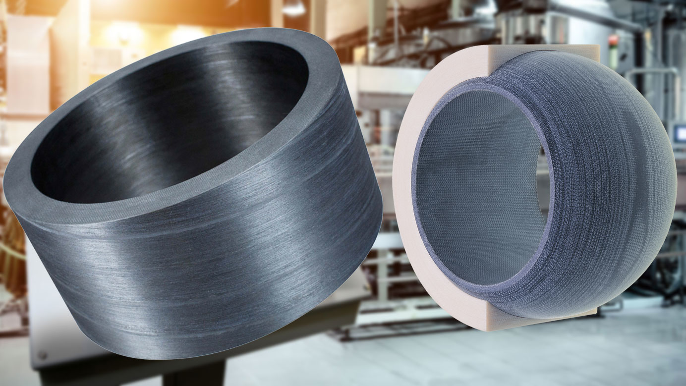

Thermoset plastics begin as a base resin. After a catalyst is added and heat applied, a chemical reaction stiffens the plastic. Often, fabric reinforcements are added to the resin to improves strength and durability.
Thermoset plastics include:
- Ester (e.g., polyester)
- Epoxy
- Phenolic
Unlike thermoset plastics, thermoplastics can be remelted and reused. This means less waste during manufacturing process, which lowers the cost of bearings. Although some thermoplastics, such as the PI polymers commonly used as bushings for jet engines, resist temperatures up to 600°F, re-melting lowers some performance characteristics and prevent some from being used in high temperature applications.
Solid lubricants can be added to thermoplastics and thermosets during production, creating bearings with extremely low friction coefficients.
