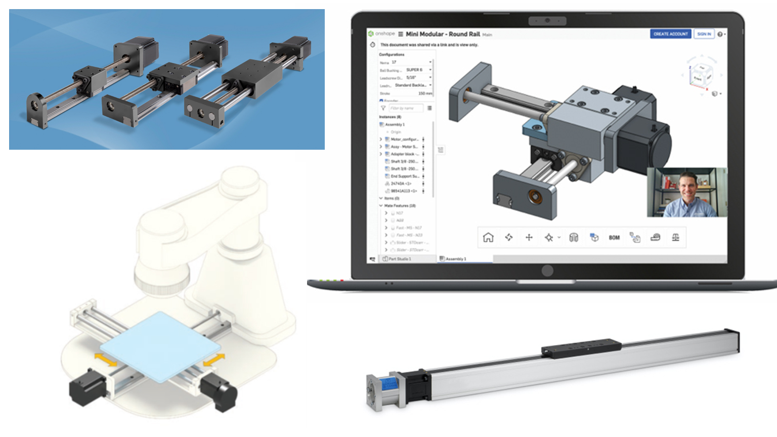

Small systems like these are often available in one of three standard configurations. When the application needs a smaller footprint but has vertical space available, the designer might choose an assembly that stacks the lead screw vertically above a profile rail, as shown in Fig. 1 (left side). This slim configuration has a smaller footprint than comparable configurations but is taller, and thus requires more overhead space.
READ MORE: Q&A: Jacob Paso on High-performance Motion Control
Where overhead space is limited, designers might arrange the screw and profile bearing horizontally, as shown in Fig. 1 (middle). This configuration flattens the configuration but demands a larger footprint.
A third standard popular configuration involves mounting round rails on each side of the lead screw, as shown in Fig. 1 (right). This version can span across gaps without requiring full support along its length. Dual rail configurations can also handle roll moment loads because two evenly spaced rails share the load.
One final example of a flexible design enables its use in dirty environments while providing positioning and movement using ball screws and linear bearings. The enclosed design provides greater application opportunities while keeping the design in a standard product family, as seen in Fig. 2.

Suppose the designer concerned with moment load handling chose the configuration with two round rails flanking the lead screw (Fig. 1). The application requirements changed during the design process, needing a higher moment load capacity. The engineer can adapt and accommodate the change starting with off-the-shelf round rails, lead screws and nuts. This may be achieved by widening the mount of the existing product or upsizing the bearings to maintain a specific envelope. Because mounting blocks are machined individually, changing support block designs can be done with little added expense and results from using standard product.
XY assemblies are yet another application that often benefits from adapting standard modules (Fig. 3). Like the previous examples, these units might require redrilling mounting holes or modifying mounting surfaces for customized gantries to accommodate cable management, limit switches or pneumatic hoses/accessories. These considerations are usually very specific to the application. But even then, much of the adaptation is made with standard mounting blocks.

Lastly, modern engineering collaboration tools are valuable for enabling real-time collaboration around the customer’s specific problem, shortening the time between customization and production (Fig. 4).
