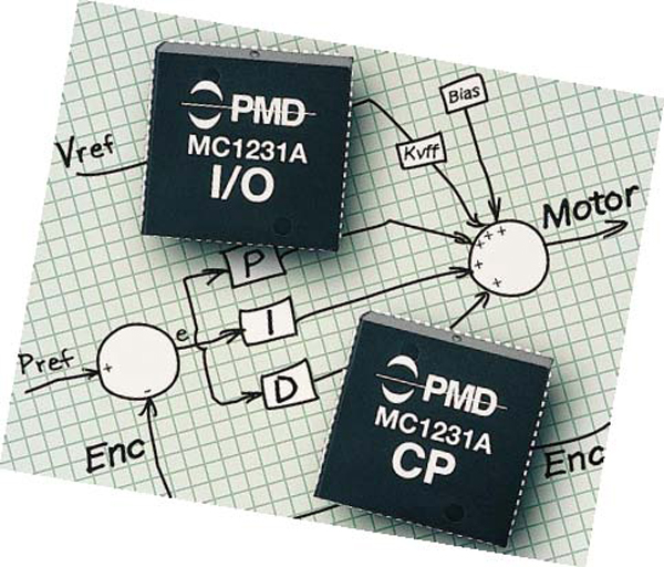

Brushless motor chipset.

Embedded motion control has become more popular over the last ten years, largely due to the emergence of off-theshelf intelligent motion integrated circuits (ICs) known as motion processors. These processors are generally built around a digital signal processor core and often have an associated peripheral circuit to handle motion-specific interface tasks. Motion processors are available from a number of manufacturers for dc servo, brushless dc, and step motors. Designing an embedded motion controller is relatively simple, because the motion-calculation and signal-processing functions have been standardized. Many manufacturers of motion ICs provide example schematics, which show how to interface the chips to various microprocessors.
